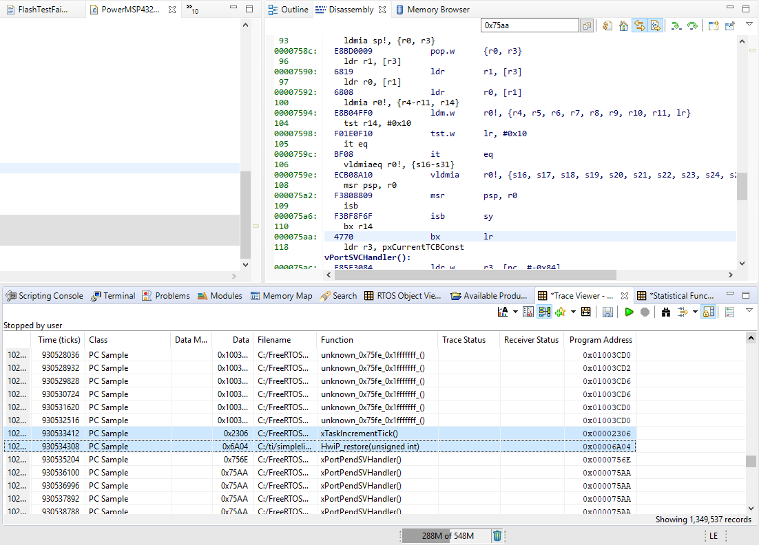

The processor crash seems sensitive to the relative offset of the instructions in the FreeRTOS xPortPendSVHandler assembler function w.r.t. the flash prefetch buffer boundaries. To control this there is the following in the MSP_EXP432E401Y_FREERTOS.cmd linker command file:
    /* Place the code from portasm.obj which contains the FreeRTOS context switching assembler routines
       in a section with 32-byte alignment, which is one MSP432E4 flash prefetch buffer, and with an optional gap.
       This allows the instructions in xPortPendSVHandler to be adjusted relative to the flash prefetch buffer boundaries
       as this can make the program run or crash.
       As of compiling this program with the TI ARM v18.1.1.LTS compiler and FreeRTOSv10.0.1 a gap of 4 or 8 bytes
       can cause the program to crash when the flash prefetch buffer is enabled. */
    aligned: > FLASH, align(32)
        .+= 4; /* Insert a gap to shift the instructions in portasm.obj relative to a flash prefetch boundary.
                  The gap must be a multiple of 4 bytes due to the .align 4 directives in freertos/portable/CCS/ARM_CM4F/portasm.asm */
        freertos_builds_MSP_EXP432E401Y_release_ccs.lib<portasm.obj>(.text)
When the gap is 4 or 8 bytes the program crashes when the FPFOFF bit is clear.
Whereas if the gap is 0, 12, 16, 20, 24 or 28 bytes the program no longer crashes when the FPFOFF bit is clear.
After the crash the debugger is locked out of the processor, so can't directly post mortem. However, by using Statistical Function Profiling found that the sequence around a crash is:
a) The program is in a call to ROM_flashProgram()
b) There are a couple of PC samples in FreeRTOS context switching (the LED flashing task is woken up at regular intervals)
c) All remaining PC samples are the same address, which is the "bx lr" instruction at the end of the xPortPendSVHandler() function.

    I think the test program may have highlighted a timing condition under which the flash prefetch buffer supplies incorrect instruction(s) to the ARM Cortex-M4F core, as opposed to a software race condition.
    I did try and capture the instruction sequence leading to the failure, but only had a SWO Statistical Function Profiler available which didn't capture instructions often enough to capture the point of failure.
    If TI can repeat the failure with the test programs, either with a MSP432E as per this thread or a TM4C129 as per the referenced thread, can the ARM Embedded Trace Macrocell (ETM) be used to capture the instruction trace in the failure case?
