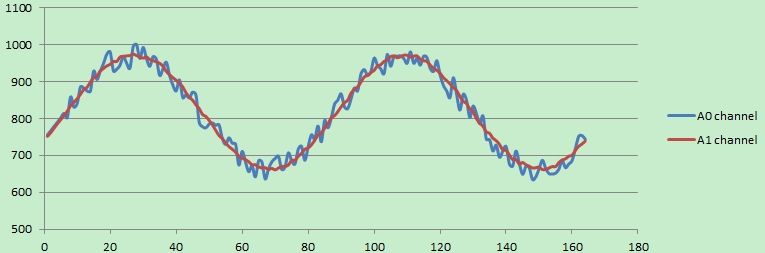

the data of A0,A1 is following:
When I change "__bis_SR_register(GIE|LPM3_bits );" to "__bis_SR_register(GIE);" ,  the CPU is always active. The samples datas is normally , the data graph :

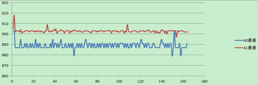

    Thanks for your help. I found the reason is "ADCSHT_15" .If I set" ADCCTL0 = ADCSHT_4| ADCMSC|ADCON ; " ,the A0 channel datas is wrong . " ADCCTL0 = ADCSHT_15| ADCMSC|ADCON ; " could make A0 sample normal.
    In programming ,how to rightly select the value of ADCSHT_x?
  • Hi
    The problem is you do no give enough time for CPU to read the first data. If the sample hold time set to short. The second ADC conversion will be finished at the period that the CPU is reading the first data. So you may miss the data at this case.
    Best regards
    Gary

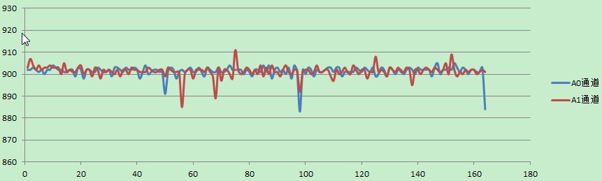

  • hello,
     Thanks for your help. But I am using the code to sample  AC signal (A0,A1 has same AC signals), A0 channel  doesn’t  work well .the datas as following
     I try to change the value of ADCSHT_x, it still doesn't work well . So I guess that some wrong things is in  the PCB electric circuits. I  exchanges the A0 channel's electric circuits  with A1 channel's electric circuits.  But  the phenomenon doesn't be improve, A0 channel's datas still don't well .  Then , I don't think any reasons without MCU. Could you give me some advises?

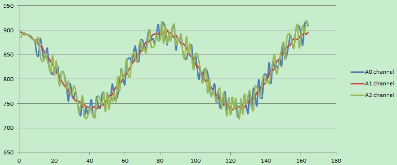

    1. I am watching EXTREFEN bit ,INTREFEN bit in PMMCTL2 register, They didn't change  to 0h during  single step debug.
    2. I try to use A0 ,A2 sample the same AC signal (connect A0 and A2 channel with wire) , the A1 channel  keep the orignal .  A0 and A2 channels has same  phenomenon ,the datas graph:
    Then , I try to use A2 channel instead of A0 channel (connect the PCB circuit of A0 to A2 channel, and  disconnect to A0 channel ), the A1 channel keep  the orignal . the datas is following:
    Accroding  to the above, I guess that the A0 channel of MCU has some problems.
    Jent
  • Hi Jent,
    thanks for doing this experiment which brings us closer to the root cause and a solution.
    As far as I know, A0 and A2 are using the same internal path. So if changing from A0 to A2 fixes this issue, it points for me a PCB issue. My intention was to change to A3 or A5 which would be a different internal path. So good that we had a misunderstanding here.
    It points for me even more on a PCB issue as you mentioned that signal is still bad on A2 if you still have A0 connected. So could you please check the PCB on A0? Are the anything else connect, long wires or wires with dead ends e.g.
