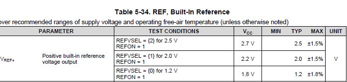

    on-chip shared reference module that supplies three selectable voltage levels of 1.2 V, 2.0 V, and 2.5 V to supply VR+ and VR-. These reference voltages may be used internally and externally on pin VREF+ if REFOUT=1. For example the P1.1.
    One thing you should take care is the accuracy as below:
