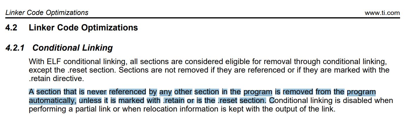

  • Hi Paul,
    A section that is never referenced by any other section in the program is removed from the program automatically, unless it is marked with .retain or is the .reset section. This description can be found in MSP430 Optimizing C/C++ Compiler v18.1.0.LTS User's Guide (Rev. R). You can use .retain directive as below.
    Code example:
    // Fixed Product Data constants
    #pragma RETAIN (szManfName)
    #pragma DATA_SECTION(szManfName, ".infoA")
    const char szManfName[32] = "Company Name";
    #pragma RETAIN (szDeviceName)
    #pragma DATA_SECTION(szDeviceName, ".infoA")
    const char szDeviceName[32] = "Bench Prototype";
