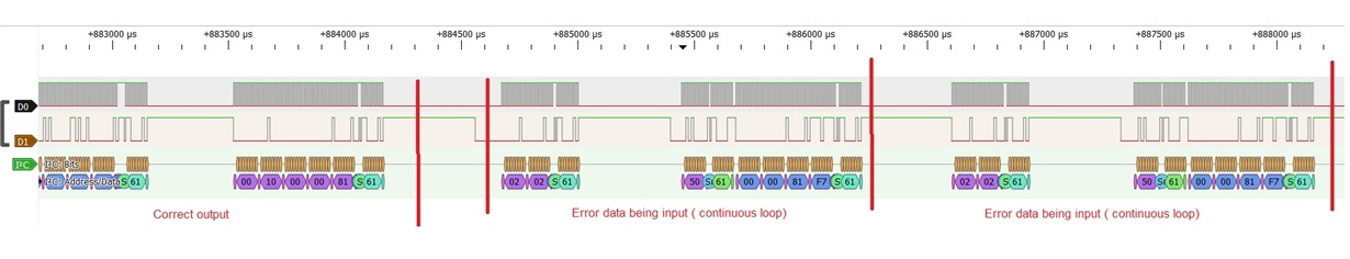

    Its just a loop to keep reading the data. Here are the 2 major problems i just encountered after looking at my logic analyzer:
    In summary there are 2 issues:
    1. The SCL and SDA line pulled to low after an unpredictable time
    2. After attaining 1 reading, the sensor data ready loops at an unpredictable time even with SEL pin connect ground or not. (i think this is sensor issue)
    Eventually the SCL and SDA line would be pulled to low (red line) all the way at a random period. When i mean by random, it means the time mark in which it drops to low is unpredictable. The longest period of data I acquired is 631ms while the shortest is 24ms.
    After the 2 lines were low, the TI Eval board has to be re-powered (USB unplug) in order for the SDA and SCL to be high again. Re-building, Re-debugging and Pressing the reset button does not work.
    Hope this information helps. Thanks once again
    Wyman Eng

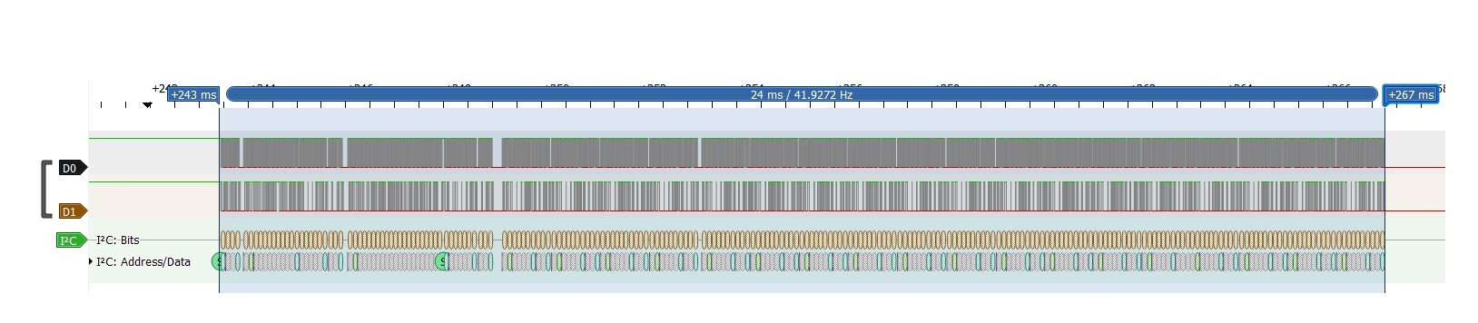

    You mentioned the 1 byte is captured in the system, would you please capture the 1-byte and the following bytes details to check the fail details (zoom in the waveform)? This should give some information about the fail.
    Jovi He
  • Dear Jovi,
    Thanks for the response. Will start off with my data results first. I only attain 1 batch of correct data before the MCU endlessly keep pinging the sensor for any data (02 02 digits) for like 600ms. For this portion, I can understand the behaviour but  why the SCL and SDA line pulled low eventually is a mystery.
    Initially I suspected clock stretching got do with it but now that you mention my timeout is disabled, its adds more to the mystery haha.  I will continue check on your Master/sensor suggestion but in the meantime, any idea why the lines behave strangely?
    My I2C pull up resistance uses 4K7 ohm resistor each for SDA and SCL line (prototype board) and for the FR2633 Capsense Dev board, I use the pull up within. same problem.
    Wyman
