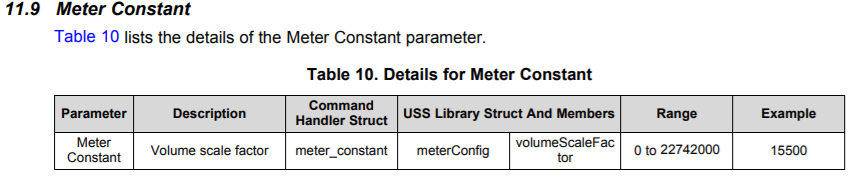

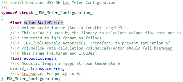

While working with the latest version of USS demo application,the observed value obtained was much lesser than the actual flow rate.I would like to know which among the following methodolgy which will be better to adopt.
1)Changing the meter constant value to a value more than 22742000 by modifying #define METER_CONSTANT_MAX
2)Changing "DC_User_Params->plot_vol_flow_rate = (float) 10.0*(alg_results_float.volumeFlowRate)" in HMI_PostAlgorithm_Update.
I would also like to know if there is any specific significance for setting maximum meter constant to 22742000.
