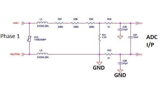

Hello All,
I'm Sensing three phase voltage individual phase wise.
Here in attached image, left side is input single phase voltage and right side is my Micro controller input.
For sensing I'm using MSP430F6779A internal integrated differential ADC.
For Programming and debugging of MSP430F6779A, I'm using MSP-FET430UIF Emulator.
when I have a given Phase 1 supply between Line-1 and Neutral and on the other side when I have a inserted MSP-FET430UIF Emulator to My Computer it get burned out, get also damaged it.
Can Anyone suggest this is right method or not ??
Please do needful.
