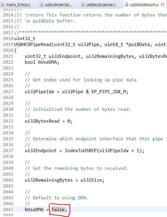

I'm trying to get the usb_cdc_serial_host_MSP_EXP432E401Y_tirtos_ccs sample to work. A CDC Device is recognized and the usbHCDEvents() is successfully called. However, back in the main task the program does not advance past the USBHCDCGetDataFromDevice() function. The function is called, but never exits, which results in the code being stuck. When I physically remove the CDC Device, USBHCDCGetDataFromDevice() quits and executes the following lines. When excluding USBHCDCGetDataFromDevice() from the source code then I am able to send Data to my CDC Device with USBHCDCSendDataToDevice().
UPDATE: I've narrowed down the problem. USBHCDPipeRead() in usbhostenum.c is called, however, the state of g_sUSBHCD.psUSBINPipes[ui32PipeIdx].iState is always "ePipeReadDMAWait". When reaching line 2241, USBLibDMAChannelStatus(g_sUSBHCD.psDMAInstance, g_sUSBHCD.psUSBINPipes[ui32PipeIdx].ui8DMAChannel) is called which returns "USBLIBSTATUS_DMA_PENDING". USBLibDMAChannelStatus() is found in usbdma.c and executes function iDMAUSBChannelStatus() on line 68.
I have slightly modified the usbcdcserialhost.c file, as I am trying to implement a USB Hub. The Hub is recognized, but CDC Devices connected to the Hub are only recognized as unknown devices. The rest of the project files are unmodified.
UPDATE: Increased task stack size.
