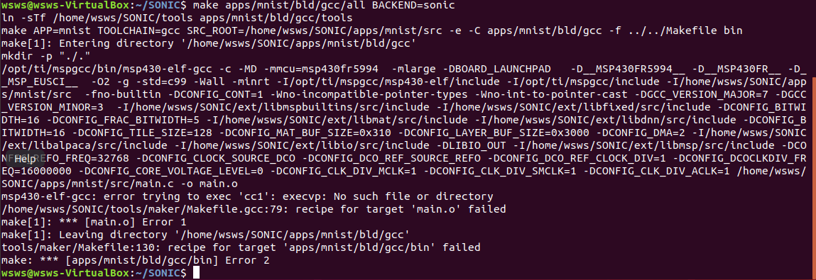

Hi everyone,
Currently, I am facing a problem which I need to build an application (e.g. apps/mnist/bld/gcc/mnist.out), but when I build the dependencies ($ make apps/mnist/bld/gcc/dep), it comes out the errors below.
For building target ($ make apps/mnist/bld/gcc/all BACKEND=sonic), there are same errors too.
Kindly pls advise what is the steps in order to solve the problem.
Thank you very much.

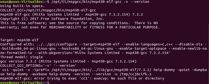

    There might be some issues with the permissions on the executable files in the toolchain.
    1. Can you please confirm the filename of the installer you used to install the toolchain?
    2. Can you post the output of running the following command:
      "ls -l /opt/ti/mspgcc/bin/libexec/gcc/msp430-elf/7.3.1/"
    3. Can you also post the output of running the following command:
      "/opt/ti/mspgcc/bin/msp430-elf-gcc -v --version"
    4. If you install the toolchain into your home directory, do you have the same problem?

  • Thank you for posting this information.
    Please can you try the toolchain only archive "msp430-gcc-7.3.2.154_linux64.7z" from the same webpage you got the installer, whilst I investigate the issue further.
    You will need to run "sudo apt install p7zip-full" to install 7zip so you can unarchive the package, if you don't have 7zip installed already.
    There is a problem with the permissions set on the files and folders in the toolchain when using the installer. The "toolchain only" archive does not have these issues and should work for you.
    We need to modify the permissions so your user can access all the files without having root privileges.
    Please run
    sudo chown -R wsws:wsws /opt/ti/mspgcc/
    This will recursively change the owner of all the files in the mspgcc folder from "root" to your user, "wsws".
    Please let me know if you have further issues, I will work with TI to get this problem with the installer fixed as soon as possible.
