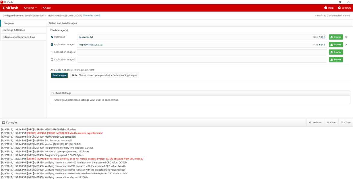

    Using UniFlash, MSP-EXP430FR5969 LaunchPad and MSP-FET, I was able to get the BSL programming to work. The MSP-FET works on this LaunchPad using the on-board JTAG connector because the BSL TX and RX pins are connected to the JTAG connector. I did have to click "Load Images" button twice, but it did work as you can see in the log below.
    Hope this helps!
