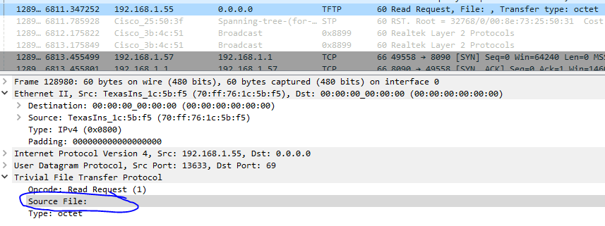

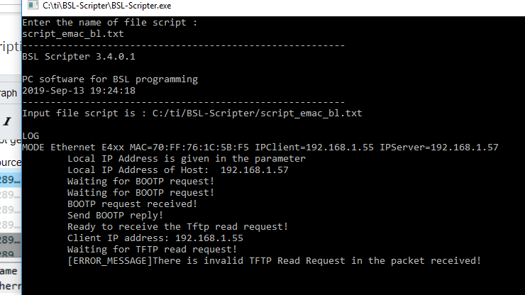

I am trying to update the firmware using Ethernet bootloader But, Even after following the steps given in http://dev.ti.com/tirex/content/simplelink_academy_msp432e4sdk_2_30_01_01/modules/msp432/msp432e4_bootloader/msp432e4_bootloader.html
I am not getting the required response from the BSL target.
The source file name is NULL in the TFTP packet.
So, could anyone please help me to sort it out.
