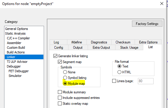

    Please create the simplest possible version of your code that only toggles an LED (so you can verify code stops working) and demonstrates this issue.
    Please enable and create a map file in IAR.
    Please zip your source, .out and .map file and provide to me.
    Thanks.
