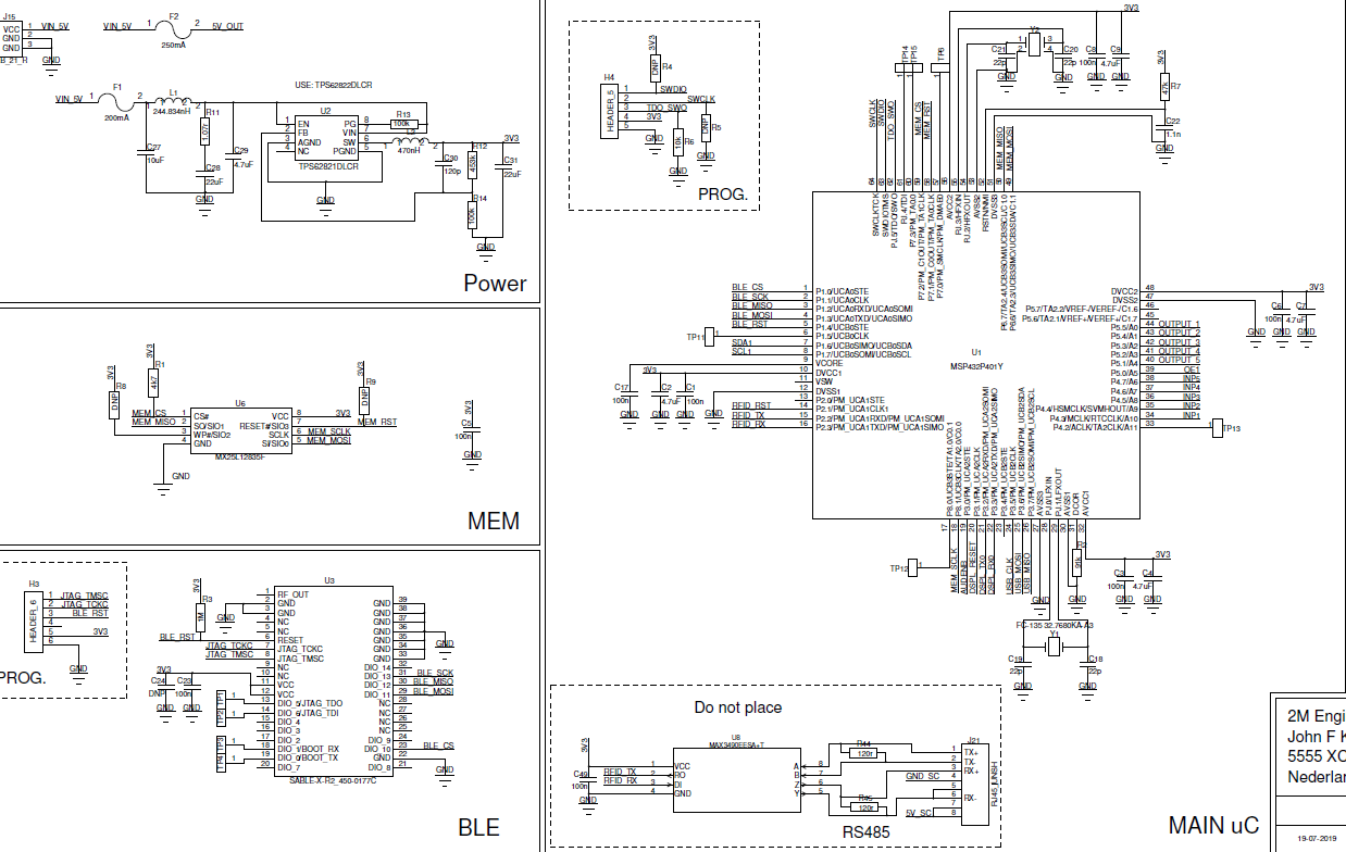

  • Here's also part of the schematics. We populated one pcb with only the msp432p4011 component and its required components to run! The pull-up and pull-down resistors are 10k. But I noticed that at the LaunchPad-4111 they are not present at all? I also note that Keil advises 100k instead of 10k. The TI documentation does not advise any value?
  • Could you please highlight the components you have actually mounted on the board?
  • Hi, only all components in the square called "MAIN uC". Pull-up/pull-down upper left are all three 100k

  • Here our schematic again of which we made the 'sample' board, in an effort to get things working! No other compoents are mounted. Power supply is external 3V3. If MSP-FET + ADPTR is used, the switch is set to 'sense'.
    From this we need to know:
    1) are the resistors in the upper left corner (SWDIO, SWCLK and TDO_SWO required or not? If so, which value?
    2) After first power up, before any flashing, we measure VCORE = 1,22V. Is this correct?
    3) Can it be software that lockes up the MCU after being flashed the first time? We see things go wrong if we start a debug session the very first time and then try to step. After the second step it crashes and we cannot connect anymore! VCORE is just a few mV after this, each startup!
    regads, Laurent
  • 1) Read the notes to 6.12.24 in http://www.ti.com/lit/ds/symlink/msp432p4111.pdf. As you see from the schematic, only R5 is mounted with a 10 k.
    2) Yes
    3) Sounds a bit strange. Does this happen regardless of the program you are trying to debug? Test with the empty example from the SDK if you haven't done already.
