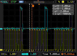

  • What does it do now? What is it that "doesn't work"?
  • So it is transmitting data, unfortantely i cant use the osci in the university to see if the SPI package is correct.
    But the Slave isn't receiveing.
    I think the Master code isn't correct.
    The Slave code should be correct, because I tested it with another Master.
  • How do you tell that the slave never receives anything?
    When I put this code on my Launchpad, I get a normal-looking CLK/MOSI waveform. I don't have an F28069M to try.
  • Because rdata = SpibRegs.SPIRXBUF; is 0.
    I checked the Baudrate, clockphase, clockpolarity, but i dont find the problem.
    I think my SPI Configs are worng.

  • That tells me that INT_FLAG is triggering, so it is receiving something (just not what you expect). The next exercise would be to try a different value for TXData -- 0x55 or 0xAA are usually useful values.
    Also: How is SPISTE wired?
  • SPISTE isn't used right?, but it's on Pin 3.0.
    I tried 0x55 but the Slave still reads 0.
  • How was SPISTE connected to the F28379D?
    F28069 TRM (SPRUH18H) Sec 12.2.1 ("Special Considerations") implies that a slave (always) looks at SPISTE, so it needs to be set up to read asserted (low) somehow or another. (The wording is a bit odd, but I'm extrapolating from Fig 12-5.) You might try setting P3.0 low and leaving it there.
    Background note: It appears to me that "3-wire" for the F28069 doesn't mean the same thing as "3-wire" for the MSP432. In the MSP432 it means "don't use STE", but for the F28069 it means "MISO and MOSI are shared over a single wire" (sometimes called "3-pin", but the terminology is a bit of a muddle generally).
  • Thanks a lot now I am receiving something.
    But it is another value then expected.
    You said: That tells me that INT_FLAG is triggering, so it is receiving something (just not what you expect). The next exercise would be to try a different value for TXData -- 0x55 or 0xAA are usually useful values.

    I expect you're restarting the master (MSP432) for each test case. Are you restarting the slave (F28069) as well? Without having SPISTE to synchronize [Ref TRM Sec 12.2.1], it seems highly probably that restarting (only) the master will leave the slave with some leftover bits.
  • I am restarting both and get the same values.
  • 1) Are you looking at rdata using the debugger? If so, do you get different results with FREE=0 and SOFT=1? That might make SPIDAT/SPIRXBUF less of a moving-target.
    2) You might try slowing the master down, maybe by inserting something like "__delay_cycles(3000000UL);" [that's 3 million=1 second, in case I missed a 0] into the loop.
    3) You could fully-implement SPISTE -- set P3.0 low before sending the byte then set P3.0 high afterward. To do this you should change the TXIFG loop to check for (USCI_B0->STATW & USCI_B_STATW_UCBUSY) to make sure the transaction is done.
    As I mentioned, I don't have this equipment, so there's some diagnosis only you can do. I suspect neither side is acting "incorrectly", there are just different assumptions.
