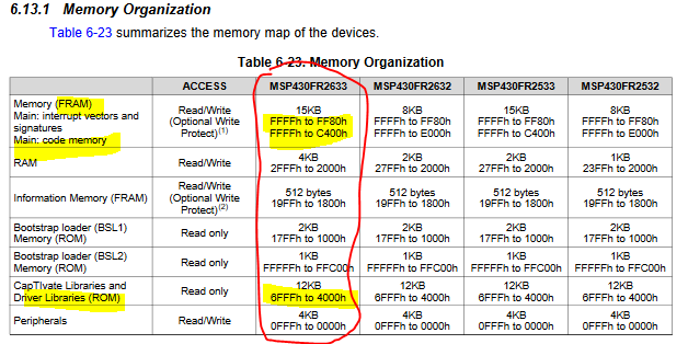

    On the MSP430FR2633, ROM is located from 0x4000 - 0x6FFF, main FRAM is located from 0xC400 - 0xFFFF as shown here.
     0x37FFE would be some where in non-existent memory.
