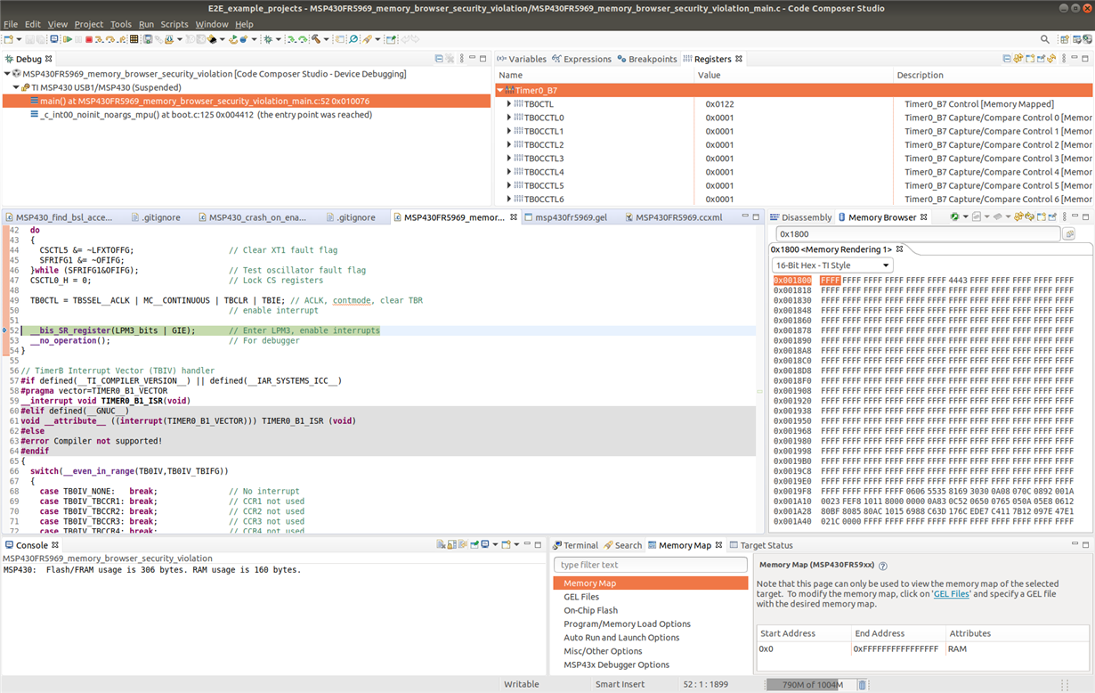

1. Download the attached program to a MSP-EXP430FR5969. This is a simple program which has:
a. Timer B0 interrupt overflow toggling the green LED on P1.0
b. Red LED on P4.6 turned on at initialisation, and turned off when S2 pressed, via an interrupt. This can be used to detect an unexpected reset.
2. Set the program running. The red LED will be on and the green LED toggling slowly.
3. At the point both LEDs are on pause the program.

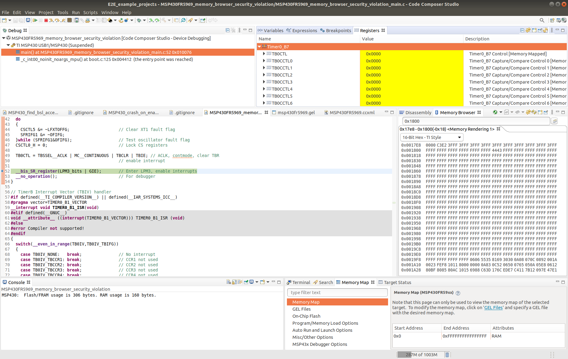

4. Open the memory browser and set the starting address to 0x01800 (the start of information memory). Both LEDs remain on.
5. In the memory browser use the cursor to move up, so the starting address changes from 0x01800 to say 0x017E8. At the point the memory browser starting address is changed both LEDs turn off, even though the CCS debugger indicates the program is still suspended.
6. Resume the program, but both LEDs remain off meaning the program has failed.

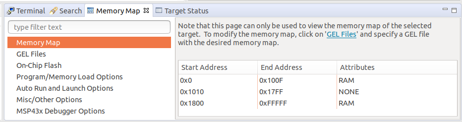

If the the target configuration file is modified to use the above GEL file then the CCS debugger is told that the protected BSL ROM addresses can't be accessed:
And if the CCS memory browser is used to attempt to access any protected ROM BSL address in the range 0x1010 to 0x17FF then get "----" displayed due to "Memory map prevented reading" and the debugged program no longer fails.
Should CCS supply default GEL files for MSP430 FRAM devices which have the protected BSL ROM addresses marked as inaccessible to prevent failures if the debugger attempts to access the addresses?
Also, the GEL_MapAddStr() and GEL_MapAdd() functions don't seem to allow specifying any addresses >= 64KB for the MSP430FR5969 with a MSPXv2 CPU, resulting in an "MSP430: Error adding memory map range: End address is beyond target memory length" error. I haven't determined how GEL determines the target memory length. For MSP CPUs the address space is 16 bits, and for MSPX and MSPXv2 CPUs is 20 bits.
