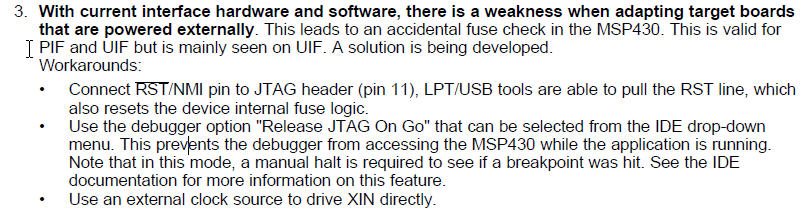

    So, your schematics says that you're using VCC TARGET (JTAG pin 4) which allows your JTAG to sense the voltage level on your target. Pls correct me if I'm wrong: when you intend to power your target by the JTAG you need to remove 3V3_JMP, disconnect JTAP pin 4 and connect JTAP pin 2 to pin 1 of 3V3_JMP, right? So, looks like your using a custom interface cable? Pls note that the JTAG interface cable lenght must not exceed 8in (20cm) in lenght!
    How many current does your application need? The MSP-FET430UIF can only supply up to 100mA through Pin 2 of the 14-Pin JTAG connector.
    Also, pls notice this Hardware FAQ (http://focus.ti.com/lit/ug/slau278f/slau278f.pdf):

    Thanks for mentioning that there is a problem with the current interface in adapting to externally powered boards. Also, I use the DCO as my clock source, should it be of any concern?
