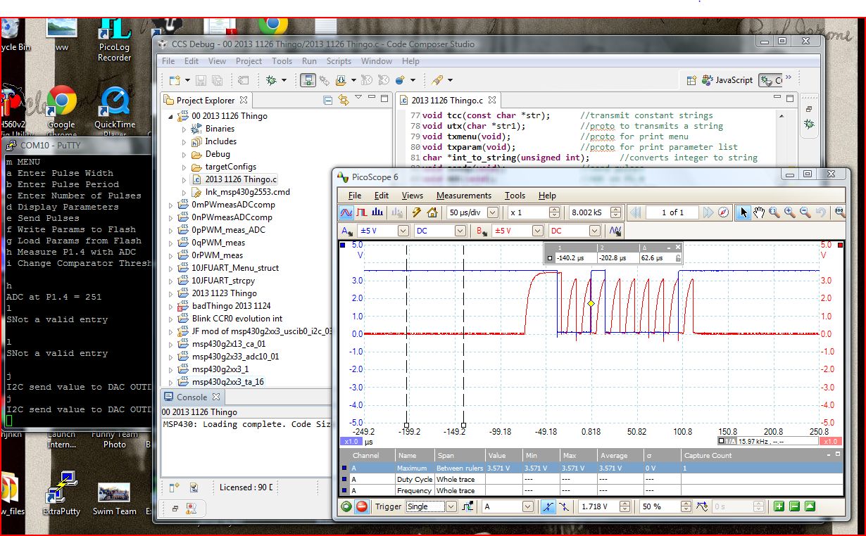

Welp, I have reached that point again where I am confounded.  I would think that if I ran the example code msp430g2xx3_uscib0_i2c_03 that if I connected an oscilloscope on either P1.6 (SCL) or P1.7 (SDA), that I would see at least the slave address being pulsed out.  I have pulled these two lines up with 10k resistors to Vcc.  I would expect them to go low as the 430 as Master sends out the slave address.  But I don't seem to be able to see any activity on either line when I start msp430g2xx3_uscib0_i2c_03 or let it free run.
Granted, I have no DAC connected to the launchpad, but shouldn't the slave address get pushed out anyway?

    That’s a good point, I didn’t check this before. With the bare demo software, no resistor enabling, in emulation mode (the debugger pulses the test-pin low, probably to give it a change) it works (address byte only, but that’s expected). As soon I add REN, even with external resistors, no SDA or SCL, I can’t see why.
    And for Braden; 10K pull-up works O.k.
  • Hi Leo. In case you already haven't, can you try your I2C code without the jumper connecting P1.6 to LED2? When the clock pin P1.6 goes high, the LED tries to draw current (if jumper is present) resulting in pulling down the line because the pin is not able to source this current. I faced a similar issue in the past. Hope this helps. Regards, Shashank
  • Ah, forgot that one.
    The same issue with LEDs also occurred to me when configuring USCI as SPI interface.
  • No that was the first I see looking to the oscilloscope, but was already aware for such, using more EVM’s with LED’s on it.
    But finally it works, only I don’t understand why it’s not working when I enable the internal resistors.
    I’m using this many times (for laziness) as a quick test with other MSP’s without any problem, I know JMG doesn’t like it, on a final PCB release I always put external resistors, no doubt. The MSP430FG4618/F2013 Experimenter’s Board don’t have pull-up’s on board and it works great, and I did the same test now with a FR5969, only internal pull-up, and works great. So this problem looks only for G2553 (if it is a problem).
  • And to complete Braden’s question;
    Remove jumper J5-2 and don’t use internal resistors (REN), external pull-up of 10K is O.K.
    I alter the software a little, so it will continuously transmit the address in case there is no slave. Also I add a Positive oscilloscope trigger pulse so you can see the whole picture, available at J5-1 (green LED).

  • Thanks to Shashank and all.  Now that I can see the i2c transmissions on my scope, I debugged my little program for testing the physical SCL and SDA functionality.
    When I run the program, I see the slave address code output on the blue trace (SDA), but I am still  puzzled why the SCL line (in red below) is held  low  up to the point of the transmission.  Maybe this is normal.

    I am trying to figure out why my SCL line (red below) stays low.
  • It’s waiting for an ACK. If you add an interrupt on NACK and here send a STOP, CLK will go high and the USCI is ready for a new transfer. See my previous example how to do.
    You got a NACK (SDA high when SCL was going up for the 9th time). Now the USCI is waiting for your decision to either send a stop condition or a repeated start.
    BTW, the pull-up on SCL is way too weak, hence the slow rising time.  SCL doesn't even reach full height during a clock cycle. Maybe you get a NACK because the SCL signal is simply too distorted to be read properly by the slave.
