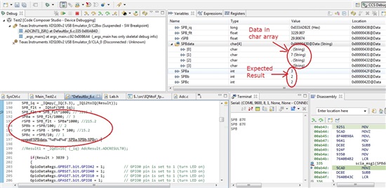

  • Hi Joseph,
    I am working on similar code. I am working on F28069 processor (C2000 application) and doing coding using CCS
    I also want to convert float to char and I tried the logic which you posted but the sprintf function doesn't seem working.
    Here I attached the screenshot of CCS Debug window. Please suggest suitable solution for this problem asap
    Then why you write in msp430 microcontroller forum? :)
  • Hi llmars...
    As I Saw relavent question, I posted my query I didnt checked the Forum... Sorry
    Viswa said:
    Hi Joseph,
      You don't need sprintf. Just use an ascii table to convert to a character. Adding 0x30 does it for the digits 0 thru 9
            valueNew[0] = hundreds + 0x30;
            valueNew[1] = tens + 0x30;
            valueNew[2] = units + 0x30;
            valueNew[3] = tenths + 0x30;
            valueNew[4] = hundredths + 0x30;
            valueNew[5] = etc
            valueNew[6] = etc
            valueNew[7] = '\0'; //string terminator
