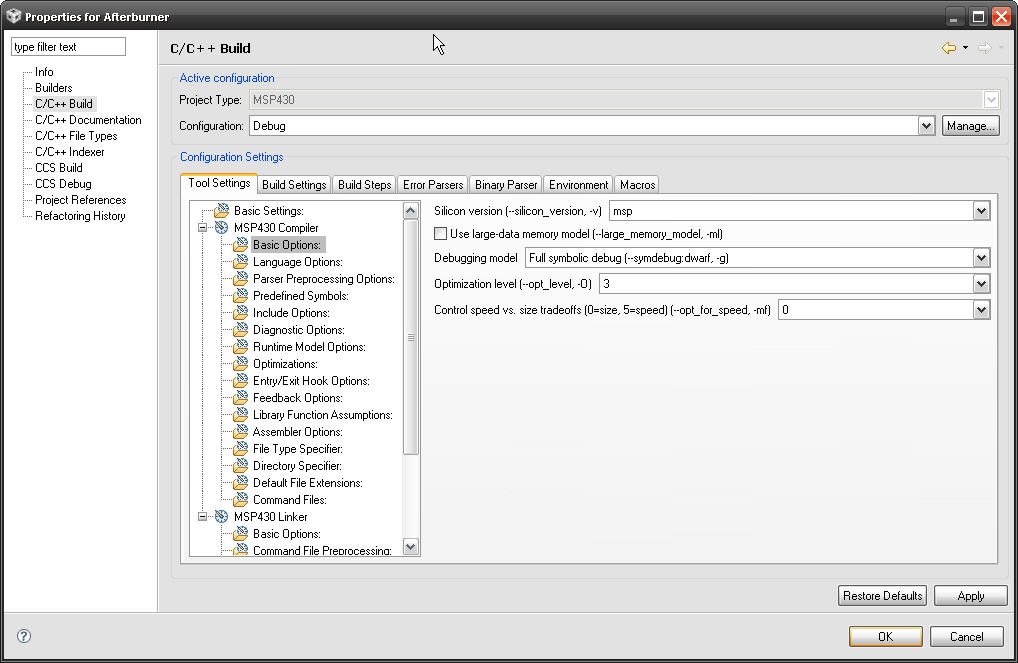

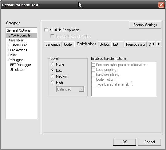

  • Hi nicolas,
    what are your settings for code optimization? In case of IAR have a look at PROJECT-->OPTIONS-->COMPILER-->OPTIMITZATION.
    The screen below shows the default settings.
    I would recommend to try out MEDIUM AND HIGH. Pls note that HIGH may result in code which may cause problems during debugging but NOT in your application.
    In case of CCS you should have a look at PROJECT-->PROPERTIES-->C.. BUILD-->COMPILER-->BASIC OPTIONS. I would recommend to try --opt_for_speed = 0 and --opt_level = 3 (see screen below).
    Rgds
    aBUGSworstnightmare
