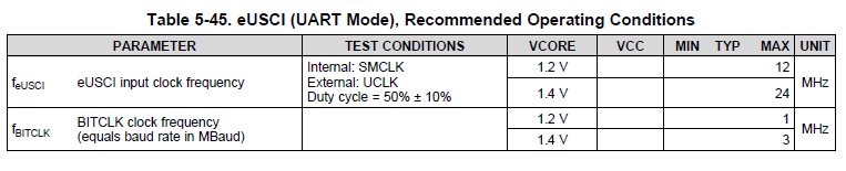

  • The MSP432 supports 3 MBaud as well:
    But you will need a precise clock source for the UART. The DCO might be too bad for that, so the crystal should be preferred.
