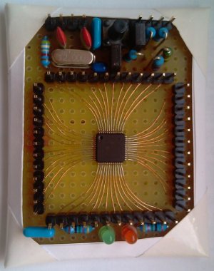

I am having issues programming the MSP430F5529 on my own prototype board.

WIRING
Moving on ... assuming the PCB is corect....I have wired up the following to my prototype board.
ez-fet prototype board
gnd to god
3V3 to 3V
RXD to UART TX ( Pin 55)
TXD to UART RX ( Pin 51)
SBW RST to RST (pin 76)
SBW TST to TEST (pin 71)
ERROR I GET
I am using ENegia version 1.6.10E18 to connect to the target. The command line error I am getting is the following:
command-line>:0:12: warning: missing whitespace after the macro name [enabled by default]
Sketch uses 946 bytes (0%) of program storage space. Maximum is 131,072 bytes.
Global variables use 18 bytes (0%) of dynamic memory, leaving 8,174 bytes for local variables. Maximum is 8,192 bytes.
DSLite version 6.2.1.1594
Configuring Debugger (may take a few minutes on first launch)...
Initializing Register Database...
Initializing: MSP430
Executing Startup Scripts: MSP430
Connecting...
error: MSP430: Error connecting to the target: Unknown device
Failed: Operation was aborted
the selected serial port Failed: Operation was aborted
does not exist or your board is not connected
Clearly the documentation is different then the evaluation Kit. But I am unclear as to why this is not working.
Any help would be great. How can I get the launchpad ez-fet to connect to my prototype board?
