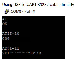

I am experiencing strange issue on the using MSP430FR2633 with Wisol sigfox module.
When I try to using USB2UART cable directly to talk to wisol sigfox module. I am able to get a response.

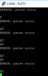

But when i configured my MSP430FR2633 with same baud rate at 9600. i always get Error: parse error return from wisol sigfox module.
By looking at the Transmit code, i am able to see AT/r/n actually sent out to wisol module correctly. But why it behave differently from the direct USB2UART cable which the input code AT/r/n is the same?

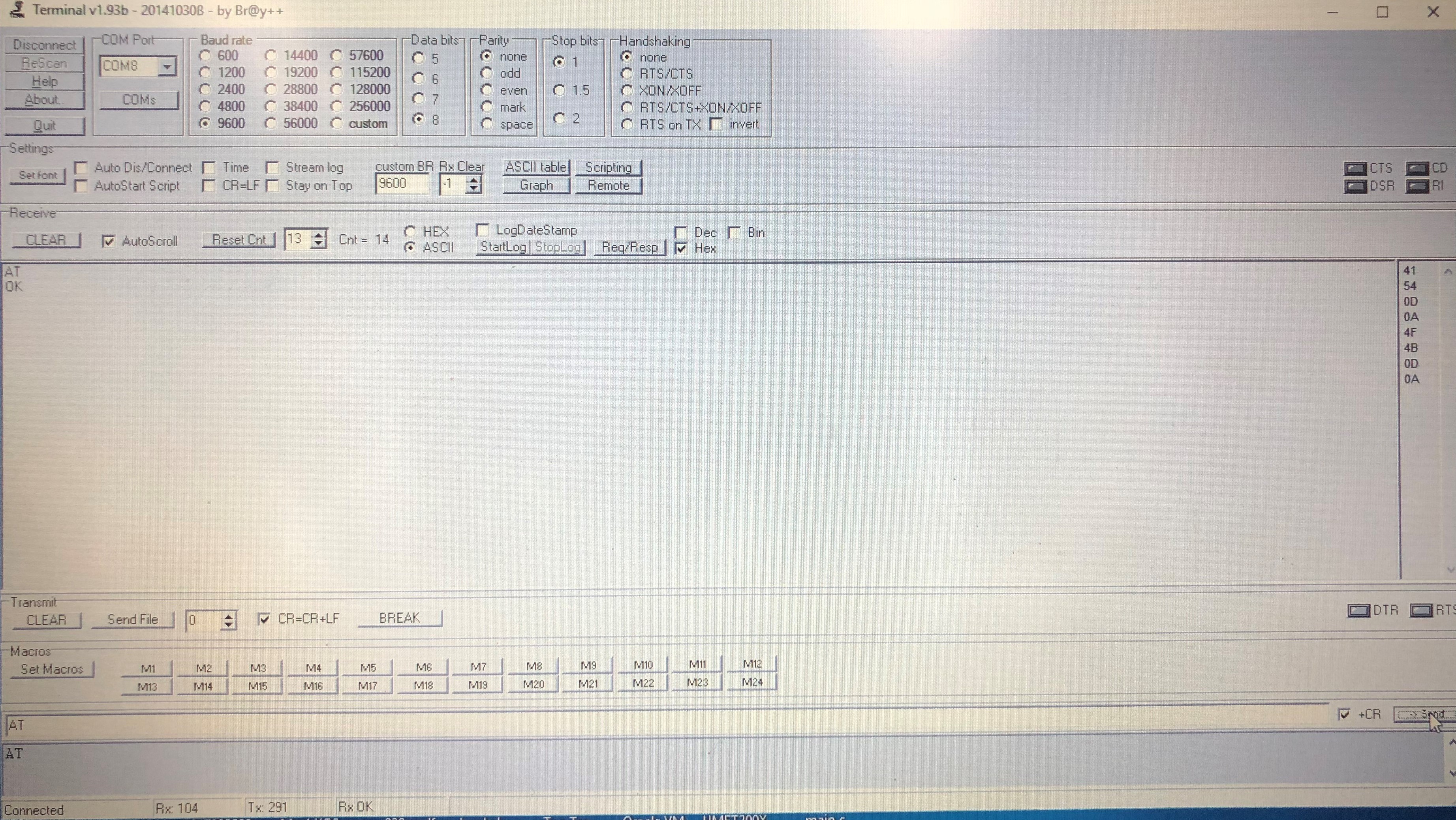

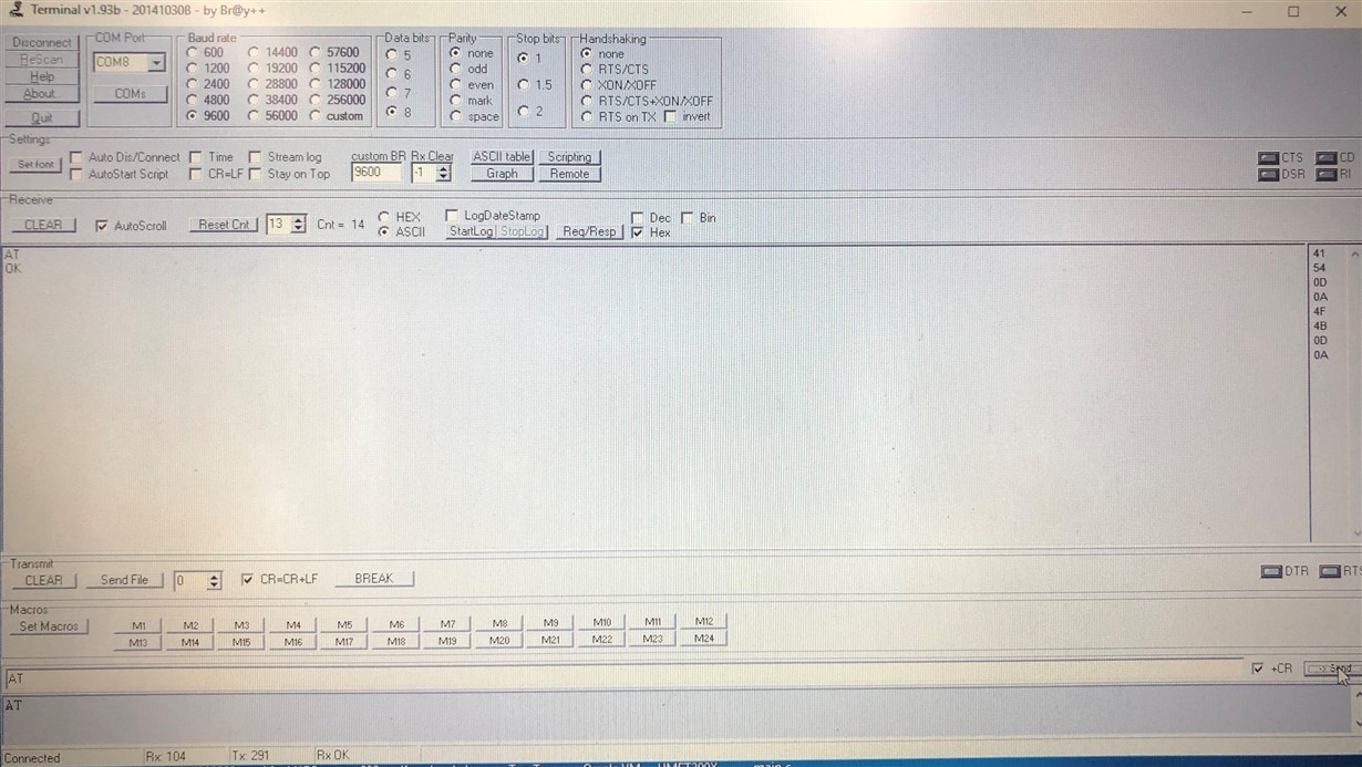

  • hi Keith,
    Yes, I did send from MSP430FR2633 MCU to Putty. All AT command can see output correctly.
    but when i connected the MSP430 to Wisol Sigfox module, I tried the tap the wisol feedback pin to putty. the screen captured is what you see.

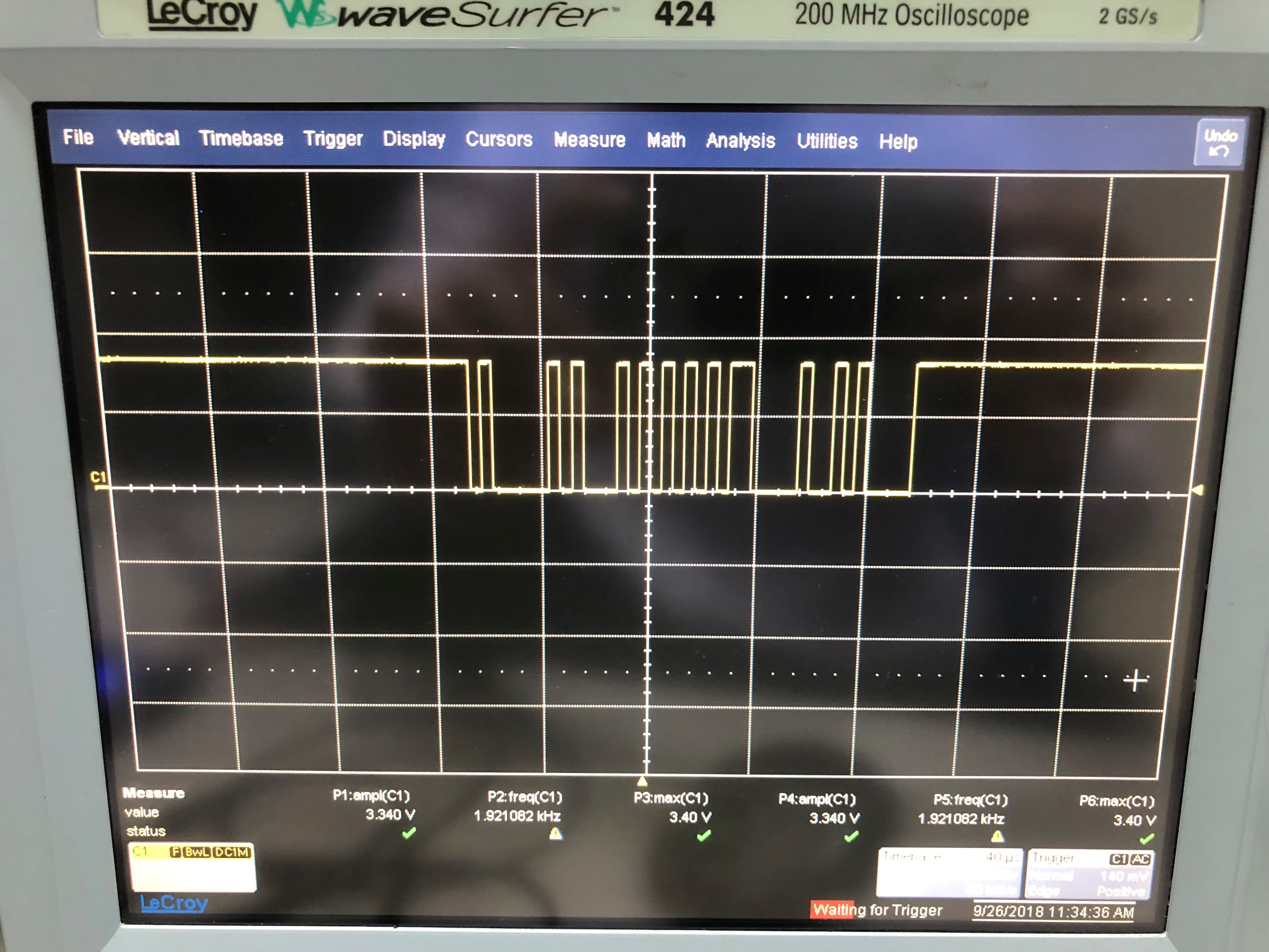

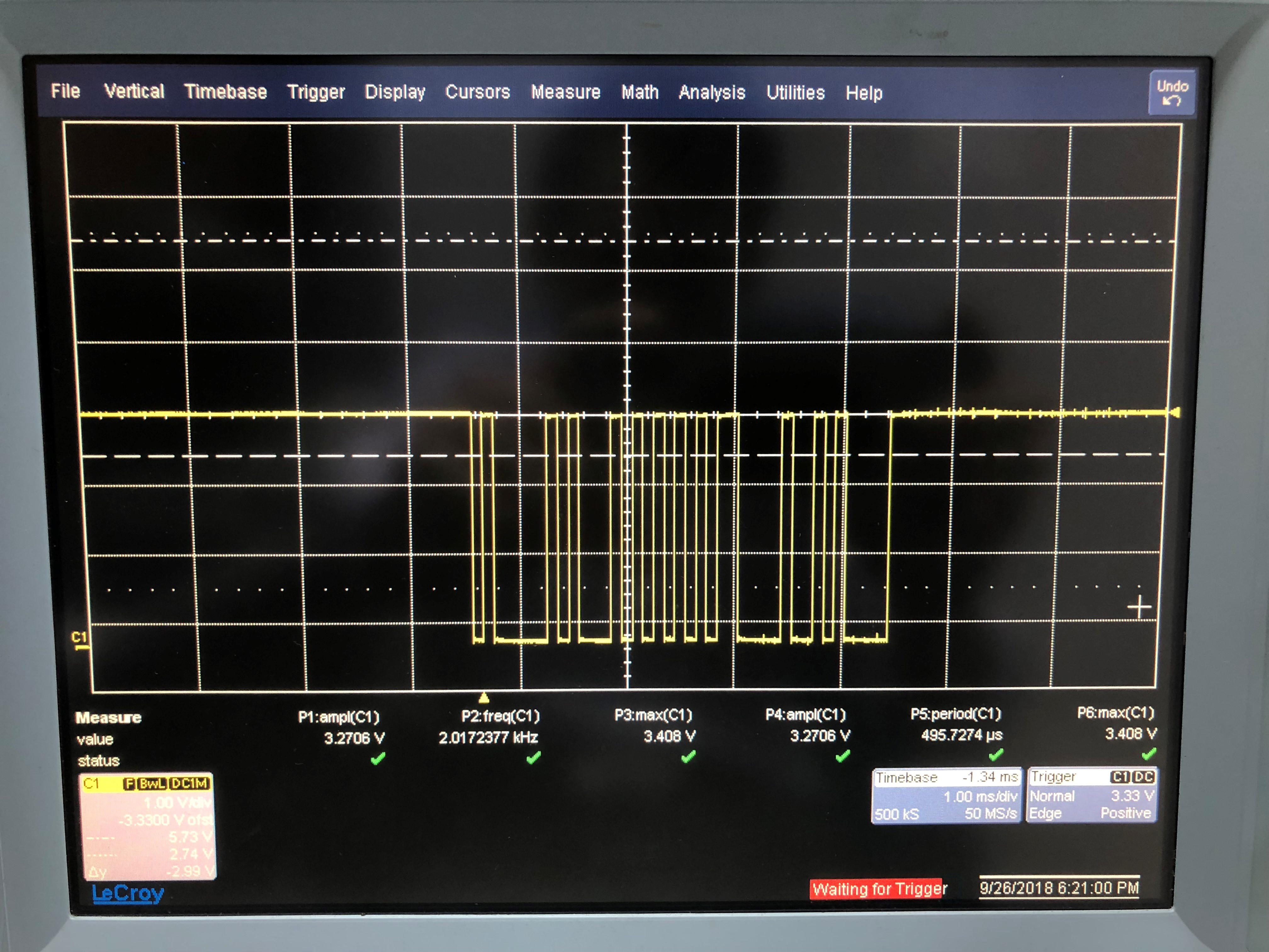

    Here is the screen captured comparison on scope between usb2uart cable and the MCU uart output.
    Picture below: MCU uart port sent output AT\r\n command to scope.
    picture below: USB2serial cable sent output AT\r\n to scope.
    by looking at the hyperterminal:
    1. when sending AT command to Sigox module, i still got parse error. retried many times still getting the same error, never get OK as per using usb2serial cable.
    2. USB2 serial terminal output always return OK.

    Plese close this case. I managed to resolved it by putting a delay in between each charater i send to sigfox module. Seem like the MCU throw out the message too fast and wisol is too slow to accept the char. Putting some delay get the right response. many thx.
