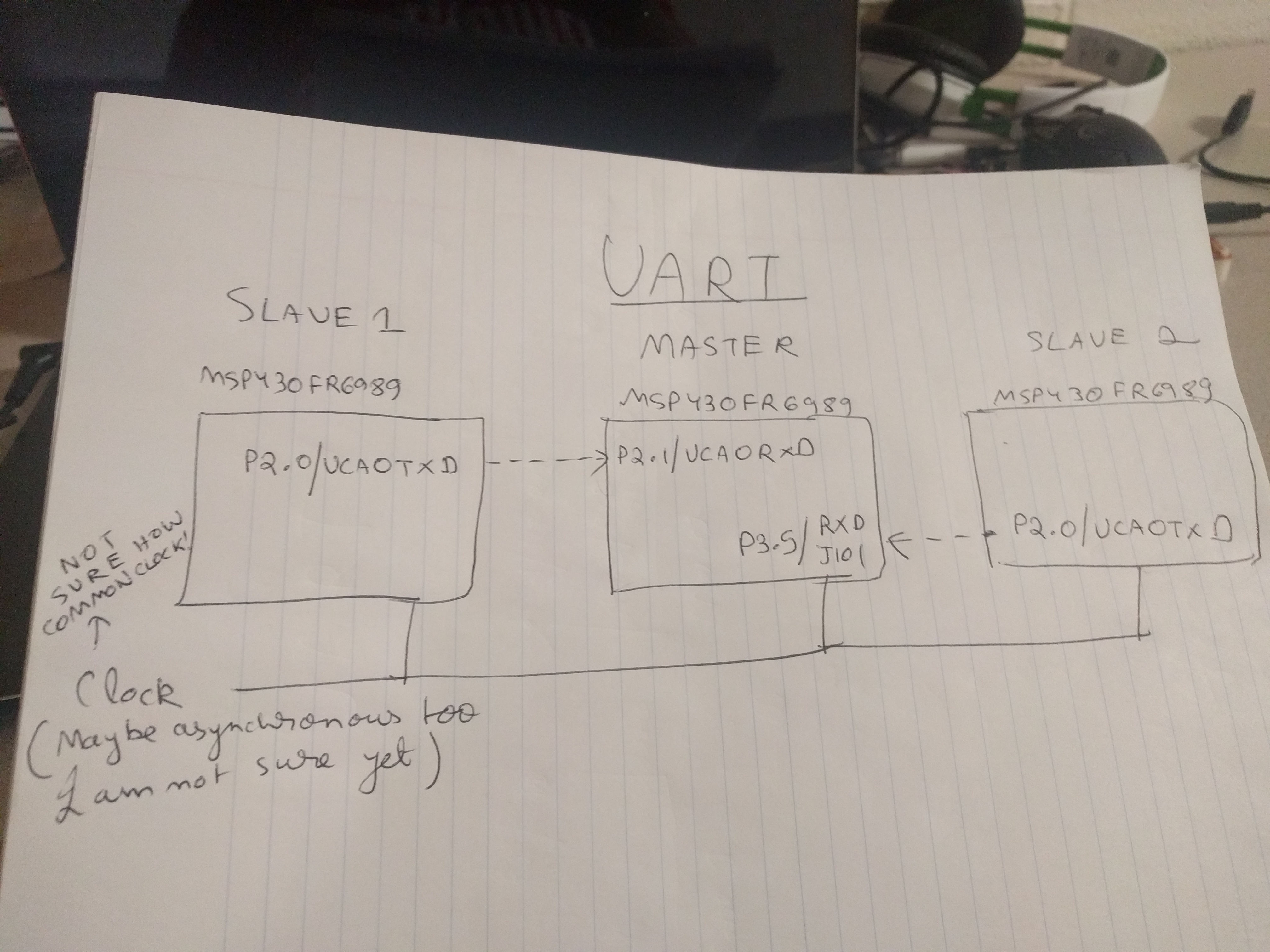

SO this is a two part question:
Firstly, on the MSP430FR6989 board, where are the P3.4 and P3.5 located? I have looked over the board and could not see the markings anywhere.
Secondly, is there a good example somewhere on how to set up UART communication in assembler (CCS) between two MSP430s (or one master MSP430 with two slave MSP430s). The example(s) I found in TI Resource Explorer is/are apparently transmitting data to itself and most of the examples online are from MCU to PC.
Thanks in advance.

    What I am really trying to develop is a simple two-person game which will involve three launchpads (two slaves, one for each user) and a single master launchpad, which will simply show the score (on its LCD screen) based off data from the two slave launchpads. The entire game might run up to two-mins max. The game involves inputs from components such as joystick, accelerometer, buzzer, push-buttons (all on BoosterPacks, one attached to each slave).
    So based off my requirements, I have included in the picture at the top what I think I need. I am just not sure how to go about from here.
  • I2C is multidrop, meaning that all the nodes are attached to the same wire(s). Each node, including the master, needs only one port. There is an explicit clock (SCL).
    UART-serial is point-to-point. The Tx and Rx pins are cross-connected (Tx->Rx in each direction) in each link. In your drawing, each slave needs one port (e.g. UCA0) to talk to the master (they don't talk to each other). The master needs two ports (e.g. UCA0 to slave 1 ("left") and UCA1 to slave 2 ("right"). There is no explicit clock, so the nodes' internal clocks have to agree; at suitably low bit-rates this isn't too difficult.
    Using interrupt-driven communication, the master knows which slave an Rx byte came from by which ISR it is executing in. You can only have 2 slaves, since the FR6989 only has 2 UARTs.
    The code for the slaves can probably be identical.
  • Okay based on your instructions, this is what I have for the Master Code and the Slave Codes (which I have included below). For the master code, I was not sure how to implement multiple UART signals so I wrote the code intuitively, setting a UCA1 for every UCA0, assuming they are declared that way. Please let me know if they look reasonable enough or where they should be modified. I based both the code off the UART 3 example for MSP430FR6989 codes in TI Resource Explorer

  • I haven't reviewed this in detail.
    I'm not too surprised that the UART code is duplicated for the two links. You could build an abstraction for the UART, but that would be a distraction. I suspect you have your work cut out for you just designing the game itself.
    What does this code do when you run it?
  • Till now, I was just trying to establish if using UART was a good idea or not. (if you read the other link, you will probably see all the discussions) I will probably start testing now. The only thing is, would you kindly go over my code for the MASTER? As the MASTER needs two UART channels set up, I am not sure if I have the syntax right or not for doing stuff for eUSCI_A1.
    The game design for the project is almost completed. (atleast the different components of it). Setting up the UART and synchronizing it with the game logic is the last big hurdle.
