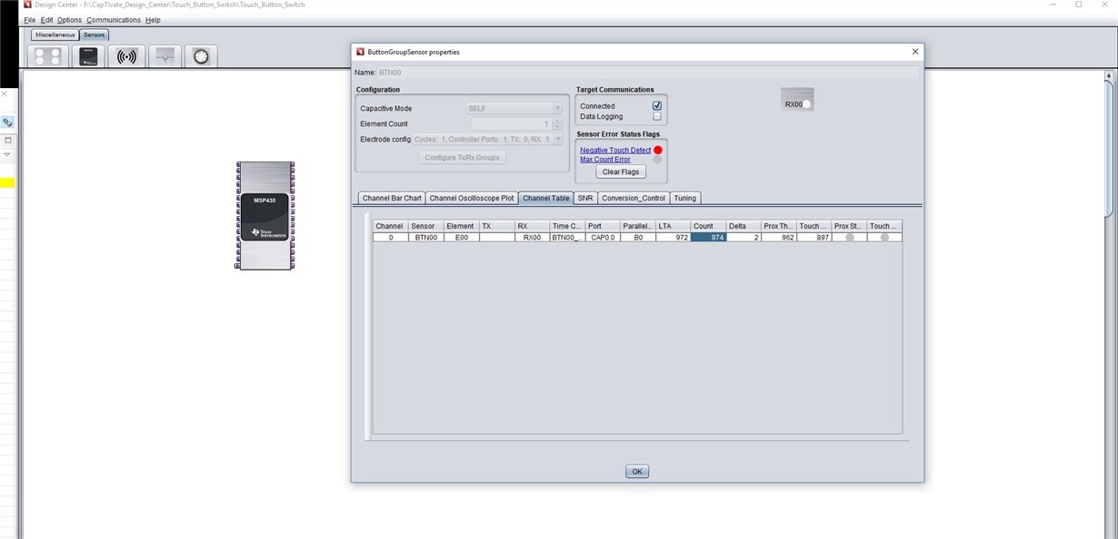

  •  Yes, i am using the CapTIvate Design Center for my system.
    The value of the variable : BTN00.pCycle[0]->pElements[0]->filterCount.ui16Natural  = 0 .
    I am attaching you a print screen of the CaptiVate Desing Center about the delta i am getting there.
