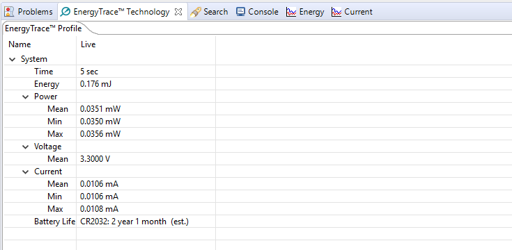

       I have been able to get the current down to 10uA making the following modifications to the MSP-EXP432E401Y Launchpad.
    (1) Remove all pullup resistors on Ethernet lines, R21-R24
    (2) Remove the pullup resistors on JTAG lines, R1, R2
    (3) Remove Ethernet electromagnetics, U10
    (4) Power is applied at 'MCU' of JP2. GND is connected at GND on J101
    (5) Remove all jumpers
    I also updated the code with the attached.

  • I did not have a meter readily available, so I used the energyTrace platform found on the MSP-EXP432P401R Launchpad.
    Chris
