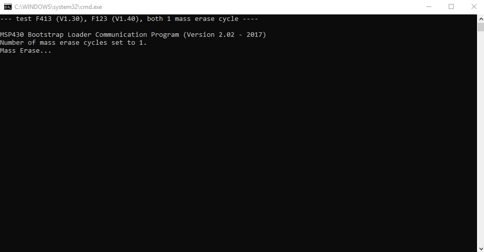

  • I have taken these step and setup the board according to
    I still can't get it to function. The board has all the appropriate lights on (Solid Red and Solid Green)
    But it gets stuck at the attached photo. I also can't seem to get anything to transmit over the TX pins when looking at the scope.

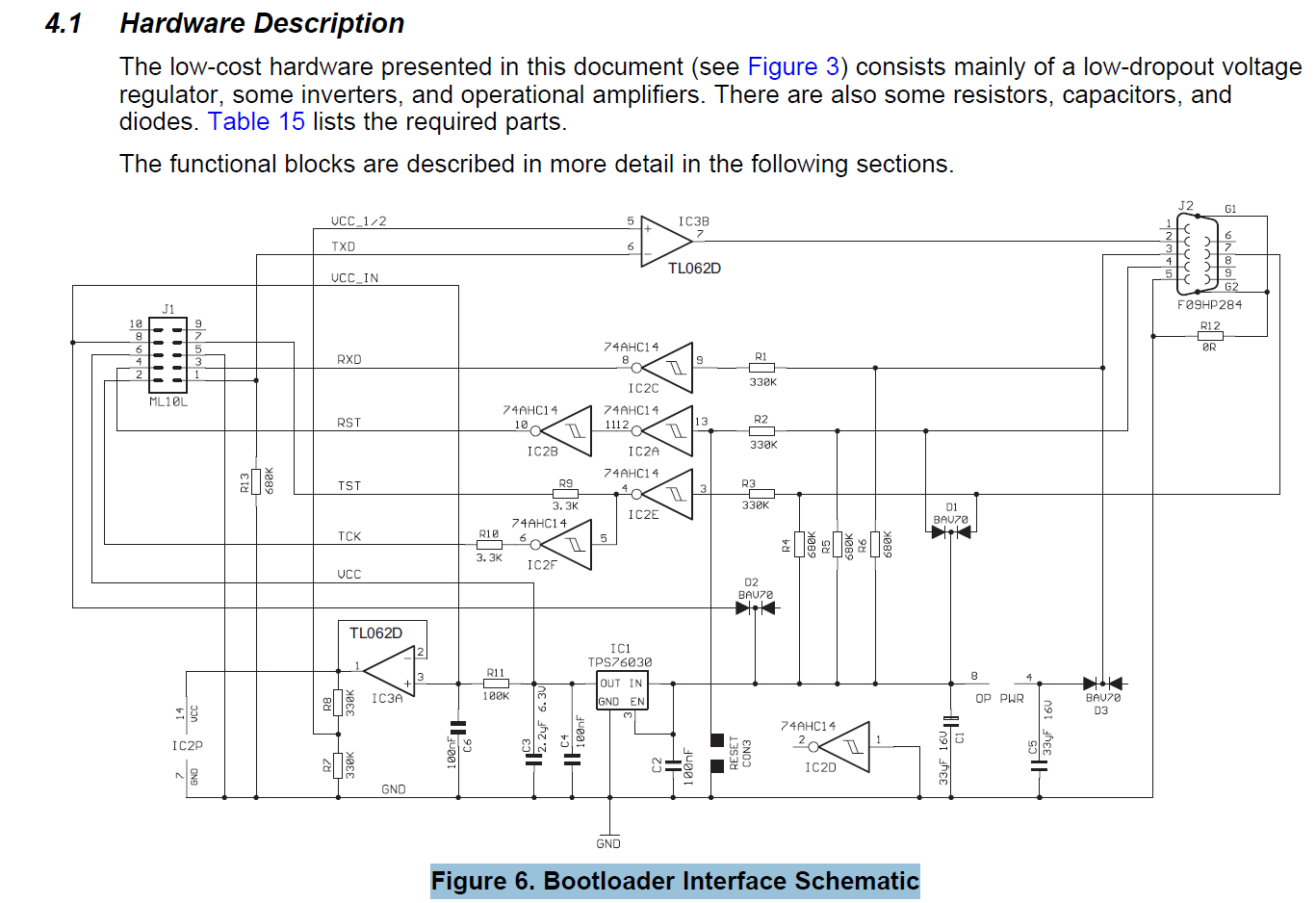

    I got help from another team that he is programming F2x devices with a tool "MSP430 universal BSL interface tool" + BSLDEMO. You can find the "MSP430 universal BSL interface tool" on website http://www.gessler-electronic.de/v2/bsl_eng_c.htm. The tool is mainly based on the HW description inside the BSL users guide and the main purpose is level shifting. You can find the reference schematic for this tool in MSP430 flash devices bootloader (www.ti.com/.../slau319w.pdf) - Figure 6 (Bootloader Interface Schematic) in section 4.1.
    Hope this information can help you to resolve the programming problem.

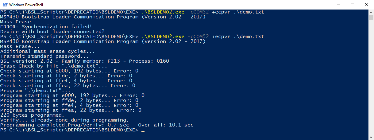

    Although the BSLDEMO is not supported by the Rocket board, there might be a workaround.

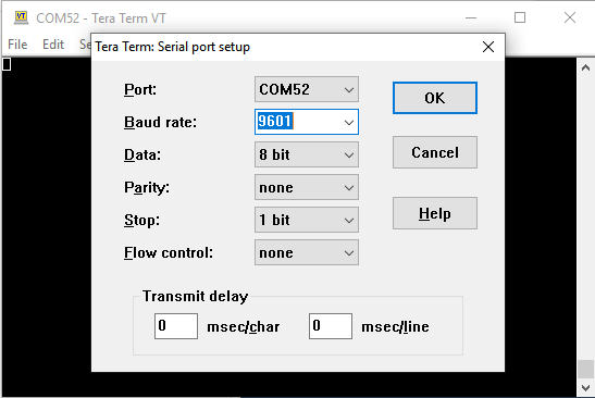

    The Rocket board generates a BSL entry sequence when it gets a baudrate of 9601bps as described here .
    So, if you try to use BSLDEMO without forcing the device to BSL mode, you'll get the following error:
    Now, you can use something like TeraTerm to force BSL. If you have an application running (such as an LED blinking), you should see that it stops running after the baudrate change.
    Disconnect from TeraTerm (otherwise BSLDEMO will fail), and then retry BSLDEMO:
    This procedure worked on my MSP430F2132 using MSP-TS430PW28 with the rocket connected to the BOOTST connector.

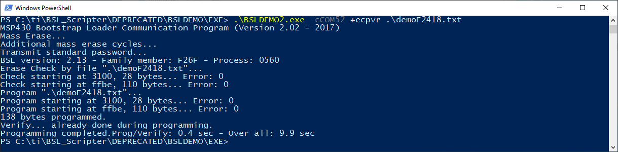

  • I also tried it on MSP430F2418 using MSP-TS430PM64 and it worked on my side too.
    Note that the Rocket uses different pins (TCK instead of TEST) to generate the entry sequence. I used the BOOTST connector with R6 and R7 on.
