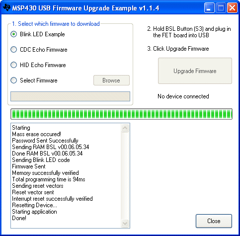

  • I guess that BSL interface is not supported by UniFlash.
    There is MSP430_USB_Firmware_Upgrade_Example (standalone Windows GUI) as part of TI USB stack with auto detection of connected BSL HID devices.
    https://software-dl.ti.com/msp430/msp430_public_sw/mcu/msp430/MSP430_USB_Developers_Package/latest/index_FDS.html
