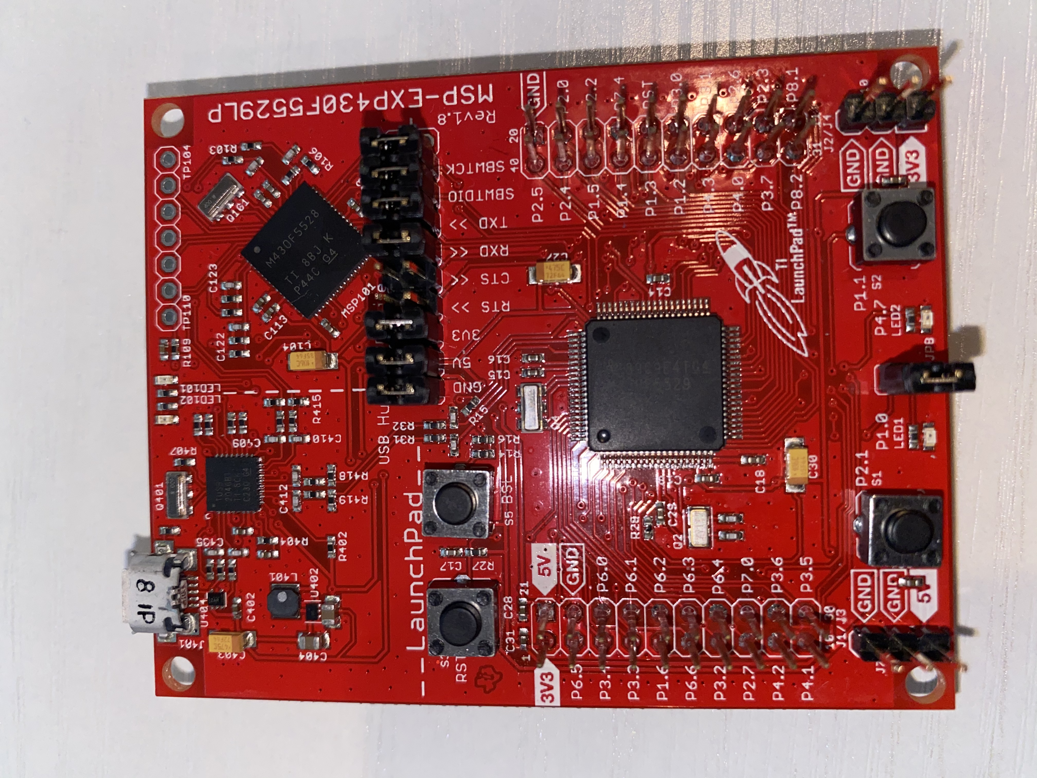

My launchpad won't connect to my computer anymore. I have a 2018 MacBook pro.
It was working fine but then all of a sudden the light turned off and I can't get it to turn on again.

Hi, Could you please change another USB cable or another PC to try connection again. this ABA test is helpful to isolate the issue. Thanks!
I already have changed cables and ports on my laptop (2 of each). I confirmed they all were working by plugging them into a different device.
Hi Katherine,
From the picture of launchpad, There is no obvious damage on the components and board.
Your feedback "I confirmed they all were working by plugging them into a different device." Do you mean the launch pad can work normally when you change the cable or change another port of your 2018 MacBook pro?
Thanks!
No, the launchpad doesn't work on any of them. I meant I confirmed the ports and cables work on another device.
Hi Katherine
I think this launchpad has been damaged. I have contact with customer support team to check how to handle this. Thanks!

Hi Katherine, I get the feedback from Customer Support team that "Since the device is within the warranty period of 90 days, we will process the replacement." May I know if you have gotten the new one? Thanks
