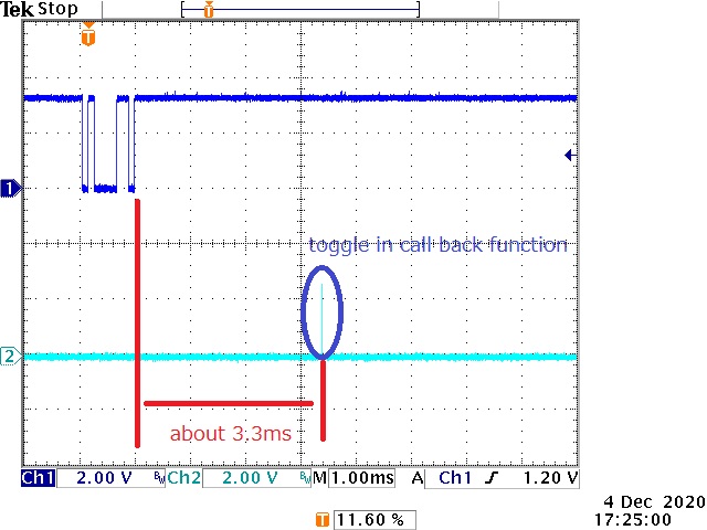

  • Hi Elen-san,
    Thank you for your reply.
    The issue is that the time between the end of uart and the start of callback function is very long (about 3.3 ms).
    We think the the trigger of callback is "Receive time-out"; however, our expectation is that callback is executed immediately after recieving uart .
    So, we want to know the way to shorten the time to callback.
    In the following figure, channel 1 is uart and channel 2 is gpio toggling in the callback function.
    Nomo
  • Hi Nomo,
    The reason why you have to wait for the callback is probably that you are waiting for a read timeout which most likely is caused by the fifo thresholds. How's the fifo configured in your project?
    Elin
  • Hi Elin-san,
    Could you confirm the project we've attached previously?
    "Ring Buffer Size" is 32 and "RX interrupt FIFO Threshold" is 1/8.
    Therefore, the interrupt will be generated every 4 bytes receiving.
    Although we set "Ring Buffer Size" to 8, this issue is reproduced.
    We want to know the way to generate interrupt every 1 byte receiving.
    Nomo
  • Hi Nomo,
    Yes, I saw the project you attached in your previous post.
    If you set the fifo level to the number of bytes, then you'll go directly to the interrupt. If not, it will be some kind of delay before going into the callback function.
    Elin
