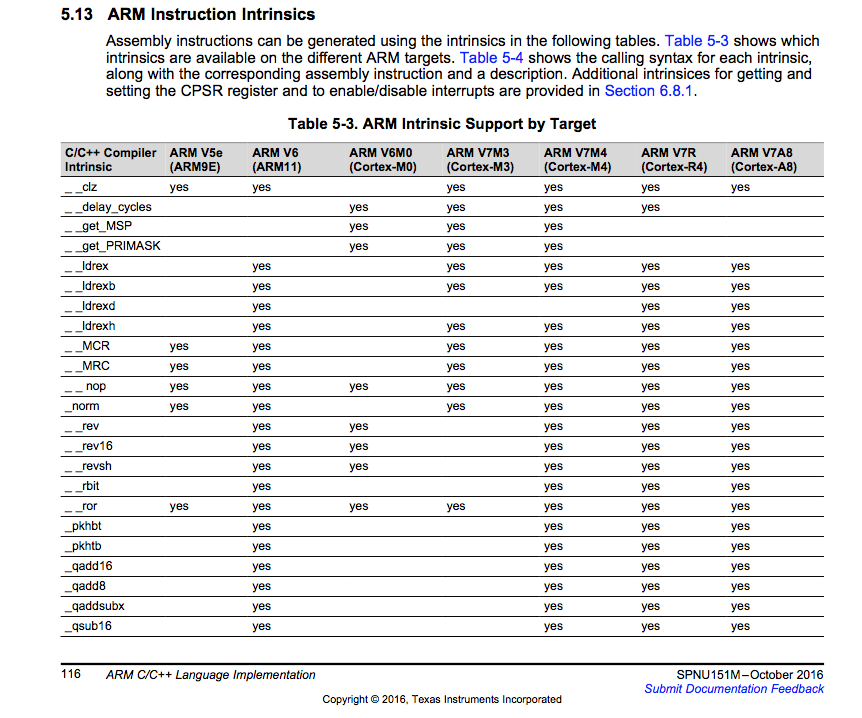

I want to make use of the byteswap instruction of the TM4C129 /CortexM4 device. I know in assembler this could be done with an gcc- code as follows:
inline uint32_t Rev16(uint32_t a)
  asm ("rev16 %1,%0"
          : "=r" (a)
          : "r" (a));
  return a;
I cannot find how to translate this to valid Syntax using the TI Compiler for the TM4C Device. Any help is welcome.

  • Your compiler has ARM instruction intrinsics.
    I am looking at the manual (my manual is for 16.9.0.STS but I doubt intrinsics would change between minor versions) and table 5-3 in section 5.13 shows a list of these intrinsics.
    Calls to these intrinsics are written in code with the same syntax as a call to a C function but the compiler replaces it with the assembly instruction.
    See the intrinsic __rev16().
    Screenshot of the document page:
    There are additional pages with many more intrinsics.
    Not sure where the link to this manual is... Maybe someone else can post that link here. :-)

  • Thanks a lot for your explanation. I can use the intrinsic function (as suggested by twelve12pm) but this might be usefull for further problems
  • Thanks, that was what I was orginally searching for!
