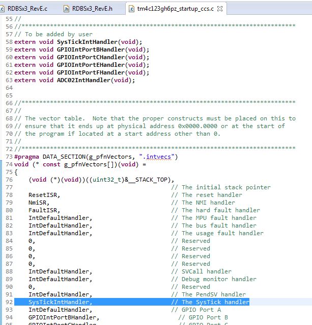

  • Hello Thiago
    To register a new function name you could use the function name in the startup file vector table. Another method is to register using GPIOIntRegister API call. However this will eat up SRAM space as the vector table is relocated to SRAM
  • Amit,
    In the Startup_ccs, where I can find the vector table, the function names are not defined, so I always defined them manually. So, this method IntRegister was new for me. Thanks for sharing about the SRAM space!
  • Thiago,
    Look at the image below.
    You just need to place the name of your function on the correct position of the DATA_SECTION shown (replace IntDefaultHandler). The example in blue works for the SysTick handler. And you also need to declare the same function as extern on the piece of code right before the table.
    Bruno
