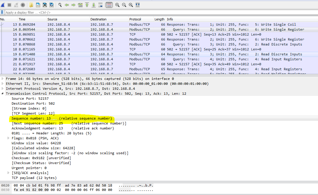

i am using third party Modbus TCP stack along with TI RTOS and TI NDK for my Modbus Slave Device. it uses TM4C1292NCPDT controller. i have captured modbus tranactions in wireshark and found always TCP ACK packets between Modbus TCP query and response. but typically there should not be TCP ACK packet between modbus transactions.
please find the log for Slave device designed with some other stuff having no ACK packtes between Modbus transactions.
find the below capture for Slave device designed with TI stuff having ACK packtes between Modbus transactions.
Modbus TCP Query.

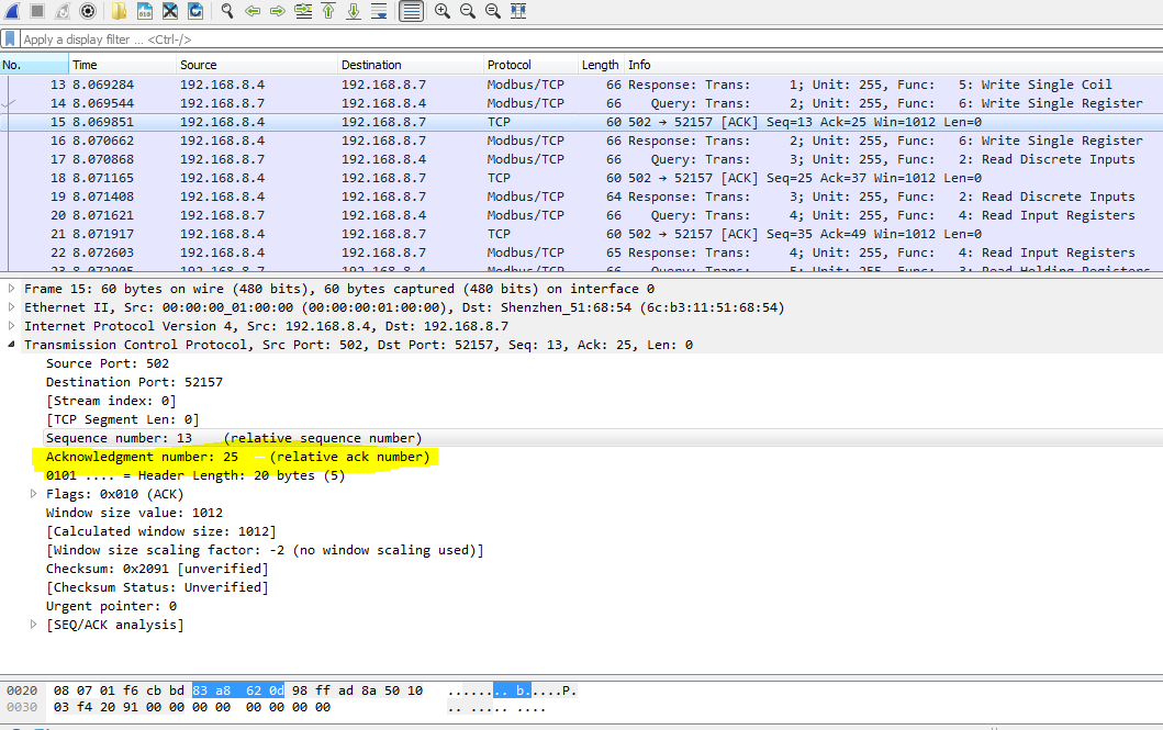

TCP ACK packets for previous Modbus TCP query sequence number.
Modbus TCP response with ACK packets for previous Modbus TCP query sequence number.
i want to know why separate TCP ACK packets is transmitted from my device between Modbus TCP transactions. i want to optimize the speed of modbus transactions, need to avoid the seperate TCP Ack packets. How do we do that in Ti NDK?

    I'm not an Modbus expert and neither a NDK expert. You are saying that there are ACK packets in between the Modbus packets and you are trying to avoid the ACK packets. Is this correct? I guess these ACK packets are generated by the the MCU, correct? Do you know to which server requests are the MCU ACK packets acknowledging to? I think this is the first part you want to look as to what these ACK packets are responding to? If the ACK packets are responding to certain requests on the network then I don't think you can remove/avoid them. In the NDK User's guide section 2.2.7.2 it talks about configuring Network Scheduler Task priority. Perhaps this is something you can look into to see if you can raise the Modbus task priority over other network tasks.

    - Actually Modbus Response itself having ACK information for the Query which is sent from PC. But here NDK is responding ACK packet for Query as per standard TCP protocol and Modbus TCP application also inserting ACK information along with response. so i thought TCP ACK packet can be removed or avoided to make use of processor bandwidth for Modbus TCP packet processing.
    is there any way to stop ACK packet in NDK stack for Modbus TCP Protocol?
