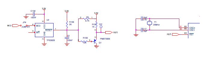

  • Are the TRST, EMU0 or EMU1 pins of the JTAG connector connected to the TM4C? They should not be. What is the level on the RST pin (pin 63)? It should be high.
    After power on reset the signal is high.
    nTRST pin of debugger is not connected to MCU nRST pin.
    we have assembled  MCU,Reset + debugger and power supply components only on the board without other component apart from these there isn't any component to cause hardware issue.
    PFA reset circuit for your reference.
    Thanks & Regards,
    Murali Prasad
  • I think I see the issue. You are using a 20MHz external crystal. All the examples are based on a 16MHz crystal. The crystal frequency for the serial bootloader can be changed on line 63 of the file "bl-config.h", but unfortunately 20MHz is not one of the crystal frequencies supported in this example. (See bl_crystal.h) Can you use a 16MHz crystal?
