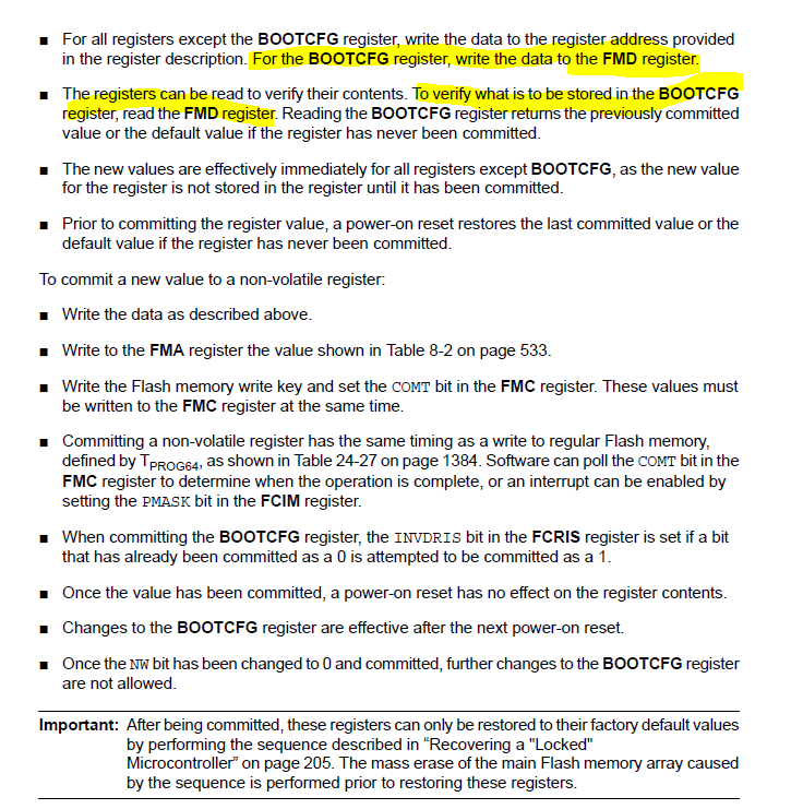

Hello. I made a new board with tiva c MCU. Now i need to protect whole firmware of reading via debug port. I try next code, but it crash execution.
    FlashProtectSet(0, FlashExecuteOnly));
    FlashProtectSave();
How to do it correctly?
