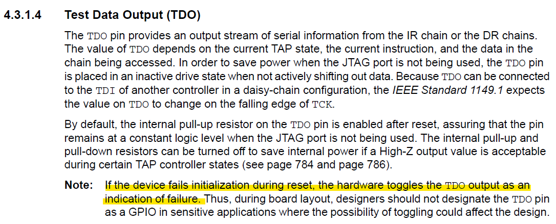

The datasheet mentioned that "if the device fails to initialization during reset, the hardware toggles the TDO output as an indication of failure."
My question is what kind of failure is that TDO able to toggle a pulse? My customer wondered if it can be used to identify some failure cases, such as flash damaged, no oscillation, pin pads damage, etc.

    If the TDO toggle occurs with a fixed frequency then that indicates that something has gone wrong during the process of boot up of the device, and if that occurs it is a sign that the device cannot be recovered and must be replaced.
    So in that regard, yes it can be used to identify a failure case, but it happens rarely and would mean that the device is unrecoverable.
    In most cases we use the TDO toggle in the opposite manner, which is to confirm if the device has NOT been irreparably damaged and that an Unlock process may yet recover it.
