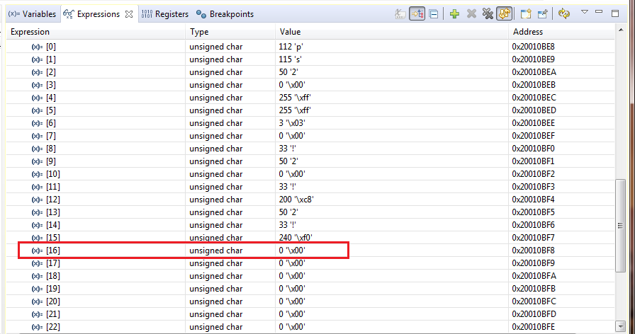

Posted some time ago RX buffer array FIFO being truncated exactly at 16 bytes or sometimes slightly > 16x8 but never full size of array buffer. After some debug time it occurs that (for/else if) loop pointer is being reset via (for char[I] size) when the RX 7/8 interrupt occurs breaking the NonBlocking loop counter char[I]. Therefore the full extent of RX buffer or input string being sent most always gets truncated for strings (>16 hexbytes) breaking up the RX data string into two commands versus one command followed by specific data.
The new challenge further increases the RX string size 32 Hexbytes which under no conditions can be truncated, must remain seamless. That is mainly due to how host command interpreter must have all argument array data present prior to passing and converting 16 bytes as strings into application variables as decimal integers.  Secondly we can not have RX handler mode Blocking (while) loop holding up the entire application in the process. So the NonBlocking (for) loop must remain contiguous up to the size of char[I] set by buffer array size.
Now that the cat is out of the bag, what to do as WA to stop buffer truncation?
Note: Null termination of strings is typically an internal application method not so much for serial transmissions over wire. So the longer 32 bytes DATA string now has bang char '!' every two hex bytes since the vendors compiler gets bitchy about adding '\0' every two bytes. Secondly Rx commands begin with 'p' and end 255,255,255 without '!'. You may ask why '!', obviously converting hex values to decimal via two bytes is shorter, faster and easier to debug than sending very long string/s of ASCII decimals.

  • Hello CB1,
    The command shared serial data buffer is shown in the CCS debug shot 1st post, s2 is the command. Charles points out the (else if empty) may be suspect in 1st code snip posted.
    Yet UART serial data rate 115200 BPS and the data string quickly follows the command to save said string. We have to tell the target it needs to handle the RX data and what to do with it. The array buffer handling method is giving fits conversion (char to int) of with CCS compiler gives no errors but pointer into array method can cause looping resets.
    Point was compiler 18.12.3.LTS C++ syntax is not fully proven with serial UART string conversions pulled from C array storage passing of data types, the competition MCU classes appear to have no such limitations. Scooby Doo there is work to do here!

    Please ask young staff to keep focus on the issue and not try to divert from it by adding scenarios that do not exist. The easiest method KISS is a two byte transfer protocol as outlined in this follow up post derived from the original question post very top of this thread. Otherwise vendor and helpers are only mildly aware something ain't working right in HW.
    Again the issue is UART FIFO can only hold 16 bytes as Charles has tried to express the empty flag can occur mid serial data transport into the receive register.
    That in of itself appears to be a HW errata in my opinion thereby making static command processing of more than 16 byte data streams highly burdensome upon CPU time. The alternative while ! empty UART Blocking mode (project example) eats up far to much CPU time even when RX interrupt calls the serial input handler.
    Again Note: Serial RX handler GPTM Polled or Interrupt  produces the very same errata, exactly at 16 bytes but is not listed in HW errata PDF.
    The FIFO empty flag should never assert in the middle of data streams as it appears to do exactly @16 bytes. One ideal WA requires branching application serial data to another BUFFER via command processor for the command processor pfn callback (argc, argv[]) handler.

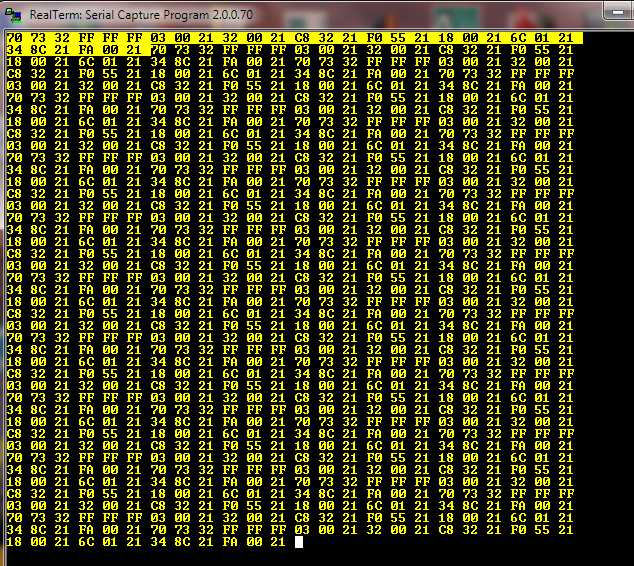

    For nonbelievers my word sender string is truncated by TM4C and CCS debug confirms a correct analysis - what goes into the RX FIFO ain't what comes out even with no SysCtrlDelays() involved in output below.
    Client several times touches the save button:
    Target lauch pad:

  • Staff reviewed your Screen Caps - believe they have 'extracted the essence' - and improved upon its presentation.      (Removed the need to scroll - thus comparison much enhanced!)
    It is believed that your transfer succeeds up to the 17th 'serial character's' arrival.    Then - the receipt has been lost.
    Staff asks, 'Can you not confine your 'Source Serial Device' to send, 'Just bursts of 16 chars?'    The thread has become so long - and filled w/extraneous - that they can not easily determine if you've made this recognition.
    If you cannot 'Control & Halt the Source' - then you must attempt to, 'Implement your own (large-scale) serial buffer' - and capture the serial data therein.
    This technique appears to be (surprisingly) 'KISS' based - and is just what the Staff here has hoped...   (You  may note that the large-frame capture image you pesented simply 'overwhelms' (far too much data included - AND forces an 'ineffective, huge spacing between each image!      Female staff eliminated that (unnecessary) spacing - so as to present that key image data  in a 'far more effective & viewable' form...)
    That 16 bytes was first attempted but noticed very difficult to see where each variable data began or ended. So the char '!' added to every 2 bytes makes it useful for strlen() on the other end to test for decoding hex to integers.

    Serial Buffer is what the top post shows beginning of thread, Cchar[I] is BUFFER 32. Later idea to add another serial function with new buffer for input data only, proved no better.
    So the last SysCtrlDelay() between if's when wider reveals timing issue may exist in RXFE flag or FIFO 7/8 threshold interrupt.

    BUFFER corruption was self caused by reading array values via array[0]=n pointers end of s2 command. Oddly using "char" to "char *" conversion variables to allow array[n] argument cell pointers cause MCU reset, even with delay between cell reads. Did young scholars tip off atoi() call subtracts '0' 0x30 from each hexadecimal input?
    Call made to HexToDec() conversion keeps base16 addition in check. It was first suspect of MCU resets due to compiler warning "char" not compatible with type "char * ". So the BUFFER is ok perhaps was being written in the end but odd values of s2 many times did not add up.
    cb1_mobile said:
    You (and your screen shots) have repeatedly noted that 'FIFO Over-Fill' causes issues.    Yet several of your Screen Caps prove that the first 16 entries to your UART-RX FIFO nicely succeed.
    Actually No, it is FIFO under run after byte 16 that is causing issues. Added delay after byte 16 may often succeed the full 28 bytes load into BUFFER. Oddly even with delay patch it may take two iterations of save command to fill 28 bytes, sometimes 28 on the 1st try.

    BP101 said:
    cb1_mobile:
  • cb1_mobile said:
    It is believed that your timings and/or methods of 'FIFO to "the BP created Buffer" data transfer is/are flawed - and it is (that) which causes the bulk of your issues...
    Again there are 28 transfer bytes NOT 16 and assignment BUFFER = 32 bytes. UARTDR Iteration loop is <= 32 loop count so the FIFO or RXFE flag control is flawed. When the receiver has start bit data after byte 16 the RXFE flag is incorrectly being set, that is silicon errata. Otherwise the HW is not compatible with C+ software BUFFER handling of the 16 byte FIFO. Perhaps RXFE flag should only be set relative the baud rate clock and not the system clock as it appears to have been designed.
    Note the addition of delay >12 inside the receiver loop code more often fills the entire 28 bytes into BUFFER abating the incorrect RXFE flag bit timing.
  • Hi Charles,
    You have been silent most follow up posts. seems a hit & run though you were mostly correct about pause. So it seems the 16th stop bit is incorrectly setting the RXFE flag even when a start bit follows. Oddly that does not produce over run error flag set via error flag check during RX interrupts.
    The RX codes for/I loop rapidly reads UARTDR register (7KCPS) bursts. During holding register time the RX data stream is highly time contiguous from the senders perspective. The added SysCtrlDelay() test of RXFE pause requires 357us being tied to BUFFER unloading of the same 28 bytes via s2 command call upon escaping the for/I loop >32. Then s2 command handler unloads the 28 bytes just received. Even with added pause it may require two RX interrupt passes to fill then entire 28 bytes, not always. Sometimes depending on RXFE pause delay, UART fills entire 28 bytes very first time and every other time there after when commanded via s2 directive several times in a row.
    The question remaining, should the RX interrupt handler clear the RTIC bit as it now does and could that be cause of random undetected byte over run on the holding register? The perception taken from serial captures is receiver holding register (under run) often occurs but that is not being tested by the UART.
