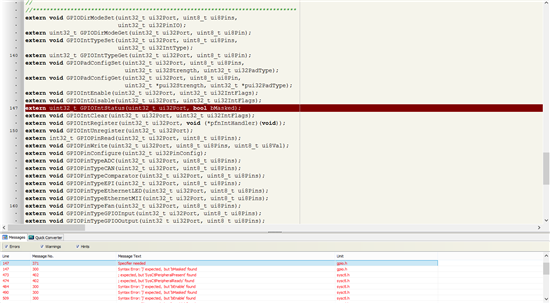

  • Hey guys!
    Tried around a bit with TivaWare but I keep getting this:
    Anybody has an idea why? The folder structure is the following: main.c with my includes and in that folder there is "inc" and "driverlib"
    Looking forward to hearing from you!
    Kind regards
    Fabian
    Add these two includes at the beginning of main file:
    #include <stdbool.h>
    #include <stdint.h>
    Petrei
  • Hey,
    They are already included (although i had to download "stdbool.h" first... crappy Compiler)
    Fabian
