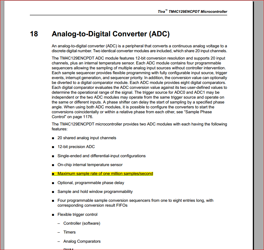

    That explains a lot!! However, I was cheated (once again) by the marketing team, and I was supposing that ADC conversion rate on 129X was 2MSPS by default.
    But the truth came out when I looked at the datasheet:

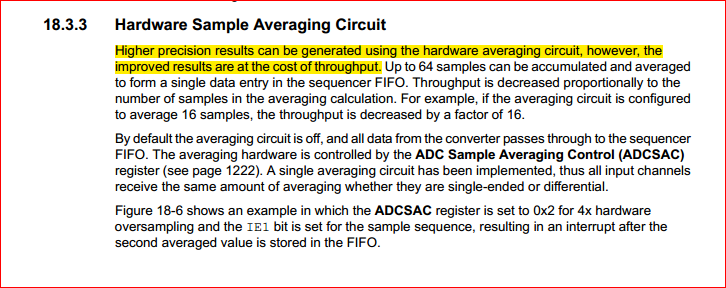

    However, this is rising some questions/doubts. When you are setting a timer sampling at 70KHz, and ADC HW averaging is 4, then you are getting an effective sampling rate of 17.5kHZ, right?
    From your calculations, it seems, that what you are getting is a 280kHz frame averaged by 4 at a 70KHz....which is not the same.
    From the datasheet, I think, the throughput has to shrink.

    The ADC always has a conversion time of 1us per channel. When using HW averaging it takes the HW average number of times x number of channels worth of time to generate the data. This has got nothing to do with trigger rate as that is something the user code has to take into account. Hence in this case the Effective Conversion rate for HW average of 4 and 2 channels is 8us which in turn becomes 125KSPS.
    Amit
