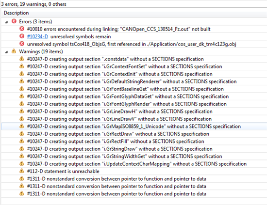

  • These are the final errors i am getting after trying multiple times.
    1. As mentioned above the 'tsCos418_ObjsG' is a structure which is well defined and i dont think its related to the source file. Its says .obj file. So its the liner issue. I dont see Why the linker is unable to find the structure defined.
    Here is the exact definition of the tsCos418_ObjsG in the header file:
    struct Cos418_Objects_s {
       uint8_t  AAA;
       uint8_t  BBB;
       int16_t  CCC;
    ** \brief typedef of Cos410_Param_s
    typedef struct Cos418_Objects_s Cos418_Objects_ts;
    2. As to the warning i have no idea what it means :( searching in google took me to this thread
    http://e2e.ti.com/support/microcontrollers/stellaris_arm/f/471/t/245329.aspx  but still no idea.

    CAn i Change to this :
    SECTIONS
    .intvecs: > 0x00000000
    .text : > FLASH
    .const : > FLASH
    .cinit : > FLASH
    .pinit : > FLASH
    .init_array : > FLASH
    i.* : > FLASH
    .constdata : > FLASH
    .vtable : > 0x20000000
    .data : > SRAM
    .bss : > SRAM
    .sysmem : > SRAM
    .stack : > SRAM
    __STACK_TOP = __stack + 512;
    Starting with the last question: yes, you can do that - but what does it means "i.*" - is it your declaration or not? If yours could be OK, otherwise remove it.
    About the error - is the .h file containing the declaration used by the cos_user_dk_tm4c123g.c file? Since this module complain first, should be checked there. I do not have any knowledge of your project... Is that structure used/modified in that file? .obj file is the result of compilation of .c file - means "object" code which is combined with other .obj files and linked to .elf file (absolute)
    Petrei

    So i will be using 'Cos418_Objects_ts' in my code which will not modify the actual structure 'Cos418_Objects_s'.
    First remove that i.* section, you do not need it.
    Second, do you have the two declarations in two separate .h files? something like this:
    #include "x.h" // this contains extern ... Cos.. G declaration
    #include "y.h" // this contains the structure declaration
    this is wrong - should be first y.h and then x.h Check your case.

    Dear Petrei,
    There is no "small red rectangle" on the file.
    Pressing F2 is equal to CTRL+CLICK and both take me to the Header file (with extern declaration) but it doesnt point me to the actual declaration in any C file.
    Thank you for pointing me in the right direction. I will find the cause to this missing declaration and update here.
  • Dear Petrie, Thank you very much for the information shared.
    The problem was that there was a #ifdef in the C SOURCE file which enabled the entire C code. I enabled that code and it generated the BIN file.
    I kept looking at the Header file but it never occured me that there should be an ACTUAL delcaration for the typedef.
