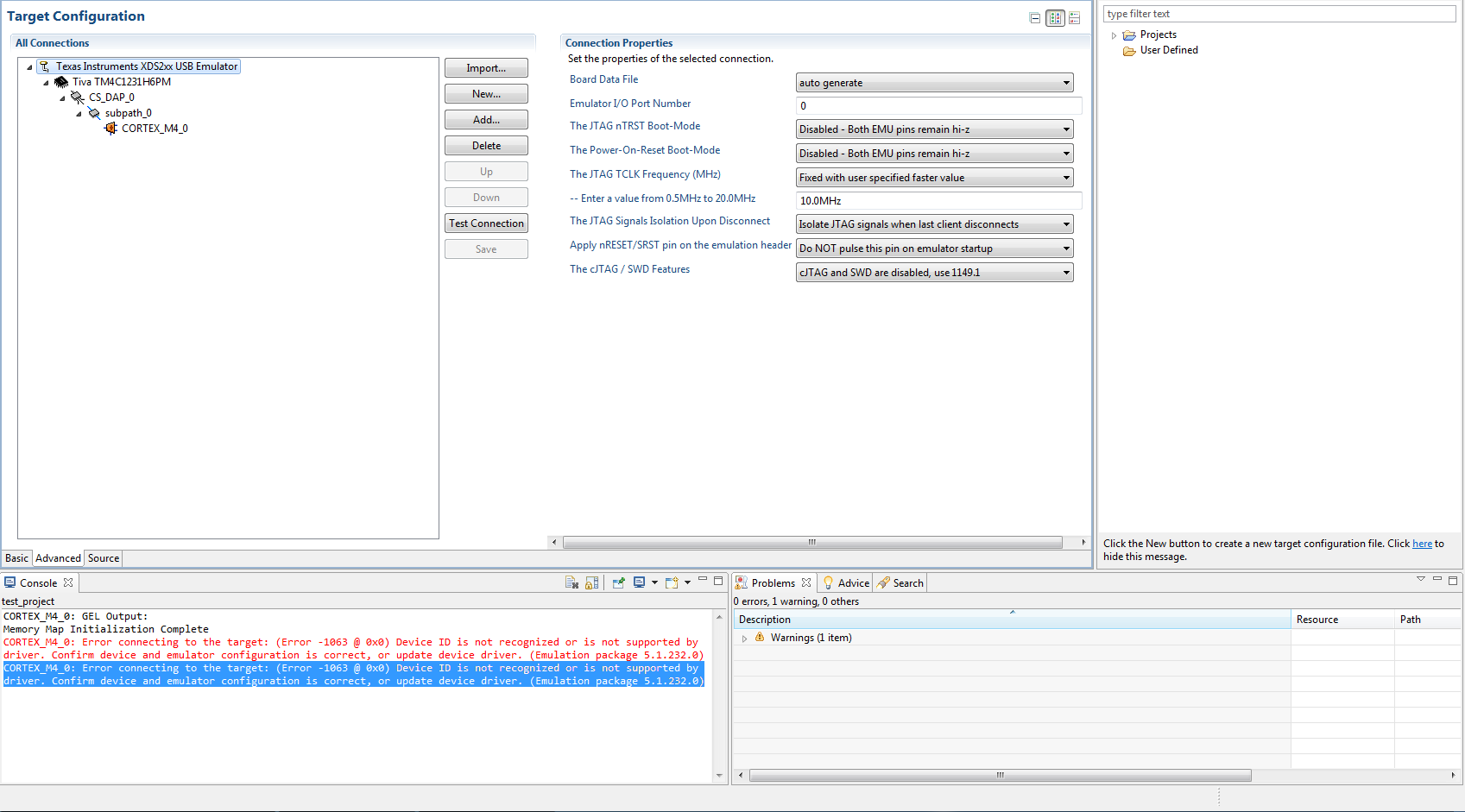

I am trying to flash code onto a TM4C1231H6PM on a custom board using the XDS200. The first time I flashed code it did flash but I got some error about breakpoints being out of bounds or something. Unfortunately I did not pay much attention to this. On all subsequent attempts I get the following error:
CORTEX_M4_0: Error connecting to the target: (Error -1063 @ 0x0) Device ID is not recognized or is not supported by driver. Confirm device and emulator configuration is correct, or update device driver. (Emulation package 5.1.232.0)

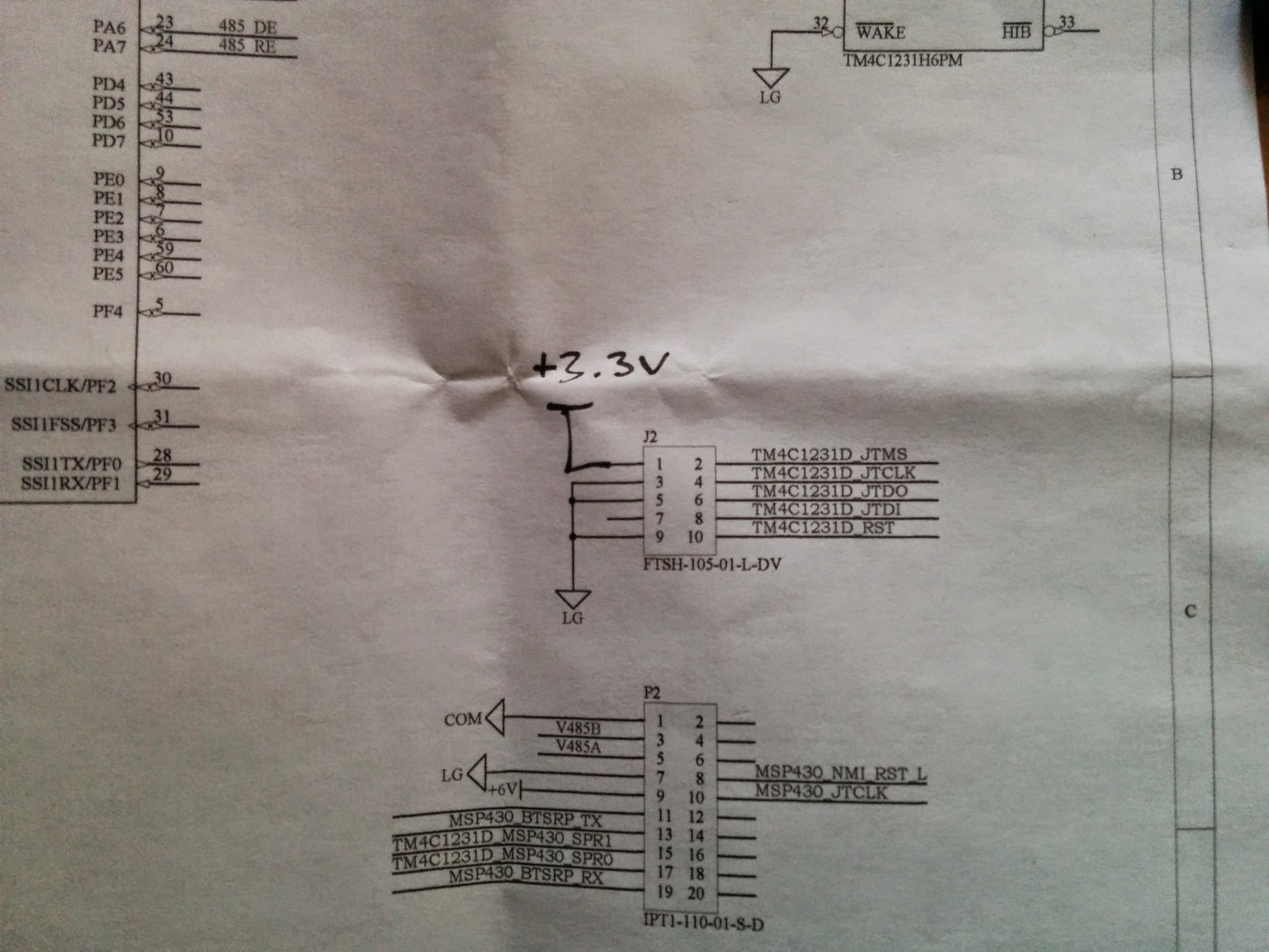

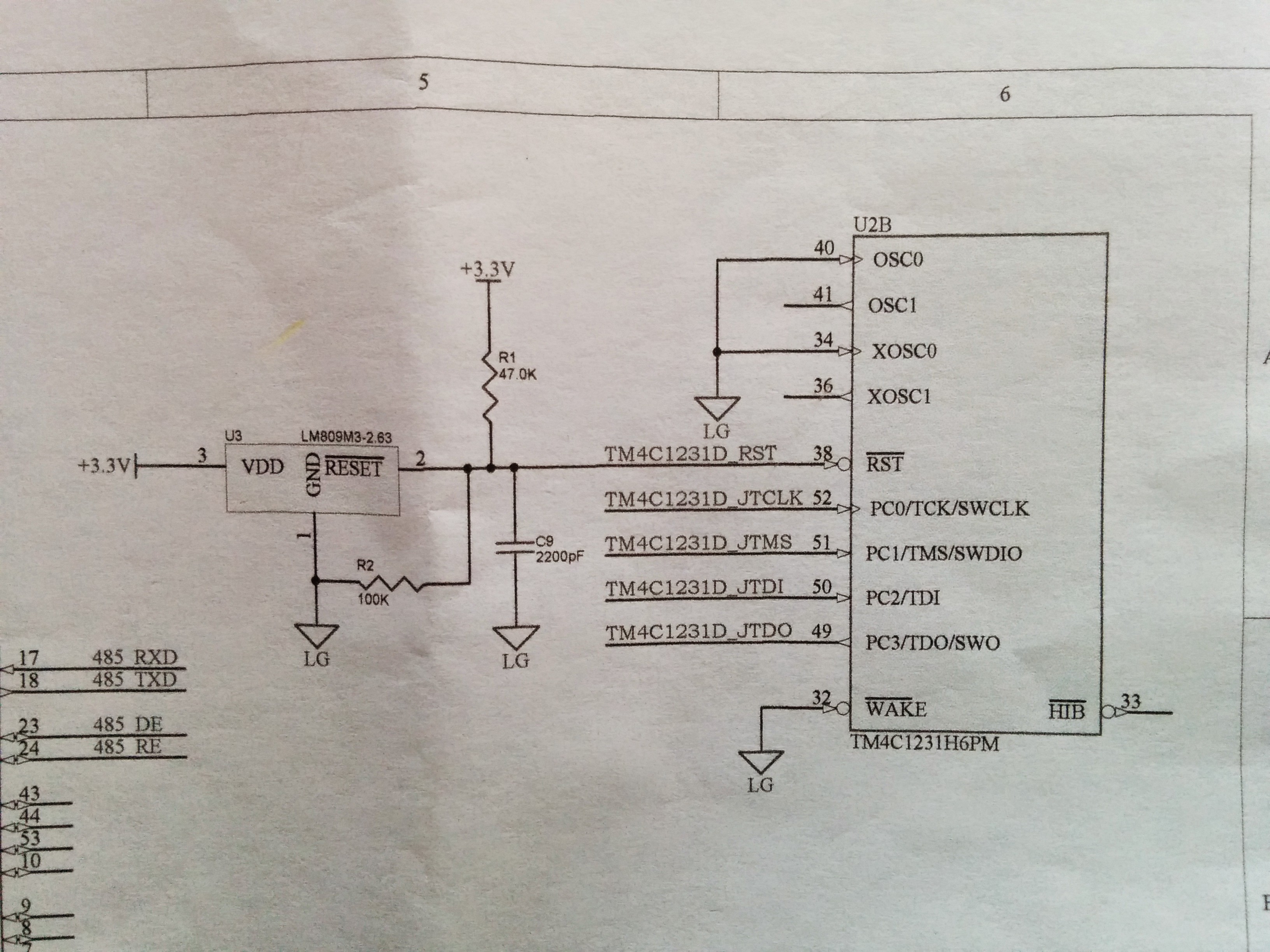

I'm attaching a screenshot of my target configuration and the relevant schematics. Any help is much appreciated!

    Great post: Detail of the relevant schematic of the board, and clear description of the issue, something which we end up in asking our forum members always to give out for basic analysis.
    Coming to the issue, since you were able to flash the code the first time around, could you look into the following things in the code itself
    1. Is the JTAG ports being reconfigured
    2. Is the MOSC being used in the code either as PLL source or system clock source? And how the system clock was being configured
    3. Is EEPROM being used by your code?
    Summary: Code post would be useful as well
    Lastly, do you have a TM4C129 or TM4C123 LaunchPad handy... If we need to run the unlock sequence.

    JTAG pins need pull-up resistors;
    According to the data sheet, the JTAG clock frequency must be lower than 1/8 of starting clock frequency, so maximum allowable shoud be 2MHz instead of 10. A more safe value of 1 MHz would be OK.

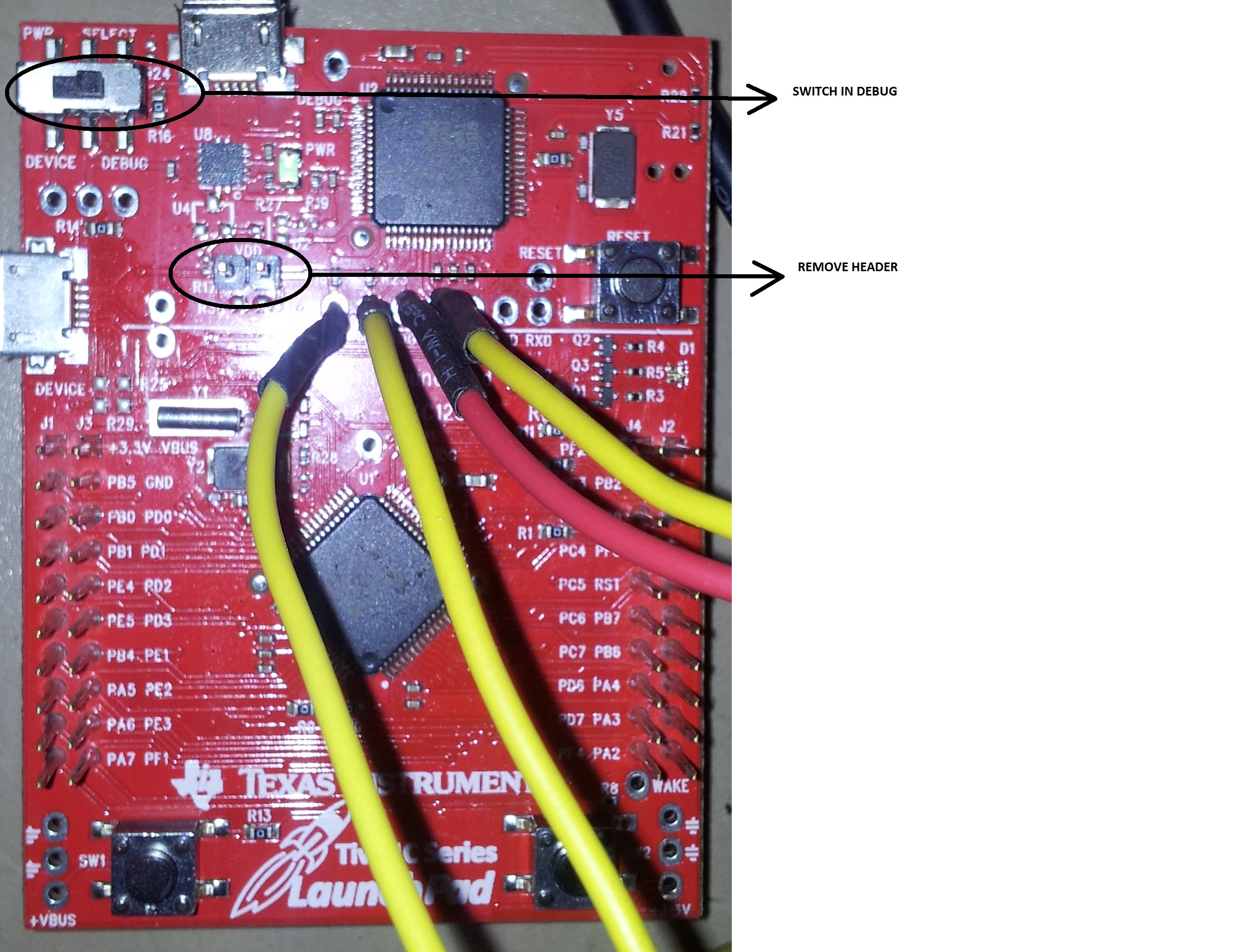

  • Hello Gabriel,
    On top of what Petrei has mentioned (Thanks Petrei as that is a vital information), you would need to re-wire the EK-TM4C123 to your custom board (remember that the EK-TM4C123 will now be your debugger to unlock the custom board).
    1. Keep the Switch in Debug Mode
    2. Remove the VDD Header
    3. Connect the JTAG Wires as shown in the center of the board (and the GND has to be common between the two boards)
    Now you can run the JTAG Unlock Sequence from LMFlashProgrammer or UNIFLASH to erase the code that has caused the problem (which has been due to the MOSC being used as the clock source).

  • Thanks Amit and Petrei, I followed your advice and am now able to flash and debug code on my custom tm4c1231h6pm boards using the xd200.
    I did not add pull up resistors yet, as this will require a board revision, but things are working for now without them.
