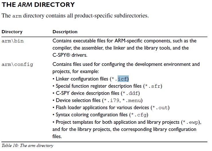

  • Joseph Curasi said:
    ... using IAR Embedded Workbench...tried modifying the .sct Linker Configuration file...to no avail.
    Our group uses IAR - usually the .icf file proves more suitable.    Inserted is a search result from w/in IAR's doc. package - we found "no match" to .sct.
    Note that there is a suggested "safe/best" method to edit that .icf file - again explained w/in IAR's docs.
