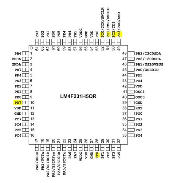

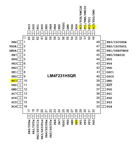

    My "prevent view" differs from yours.  I suggest asterisk and/or "coloration" to make each/every such special pin better stand out!  And - I believe the pin-out MCU drawing should be an obvious place to so highlight.  The use of GPIO chapter - as is presently done - even w/tabulation - has long proven insufficient.  (I do appreciate your effort & it is an improvement - but I doubt that it is as impactful as stronger methods I've/others have suggested)
    I'd place such "key pin warnings" front/center Page 1 (Mgmt will love that, I realize) and upon each/every pinout drawing - as well as the method you describe.
    Your interest and involvement is - as always - appreciated...  Some here have "visited" for awhile - and hate to see users endlessly "set adrift" - when safe harbors exist and could be far better marked... (especially when such harbor markings bear "NIH" and "free"...)  Here (non-NIH) - quite simply - has not yet proved, "up to task..."
    To best illustrate: (cb1) (this works even for those who studiously avoid "reading the fine manual") QED!
    Note - minus those highlighted "warnings" users too easily, "fall victim" to the NMI & JTAG usage issues...  As now exists - all pins look "up for grabs" - we can - and should - do better... (even if beyond "10 minutes" is required...)
    Pins highlighted require, "Special Handling" - please review GPIO Chapter for important details... (credit cb1)
