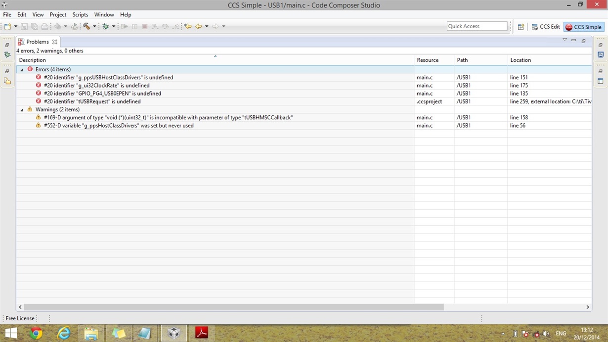

I'm currently developing  a USB Host CDC for the TM4C123 and am hoping to find some examples or get some suggestions on how best to approach this.
The USB Device I need to host is using the Microchip USB Stack and becomes a virtual serial port under Windows as the USB Endpoint is an ACM (Abstract Control Model) USB subclass.
I have seen the example developed by Leo Hendrawan - http://processors.wiki.ti.com/index.php/Stellaris_-_USB_Host_FTDI
But this is for a device with an FTDI chip, I am assuming this code can be worked on, but have not been able to work out where to start.
Any and all suggestions welcome!
  • I should mention I have read the TivaWare USB Library User Guide. And although it goes into extensive detail regarding Device CDC, it does not mention Host CDC once.
    So where should I start? I can see that utilising USB Host Controller Driver for a few things , but will I need to also work directly with the USB DriverLib API?
    Anyway, I was hoping that for such a common USB class there would have been a few more higher level APIs available.

    Are there any technical reasons that a Host CDC ACM example hasn't been developed after all these requests?
    I'm giving it a go, but I'd hate to waste time on something that wasn't technically feasible!

  • /Dear all,/
    /here I have written some code for USB detection and writing data in pendrive,
    /please see to it and let me know errors.../
    /I have attached screenshot for errors/

  • Since your issue is now unrelated to the original post.....I am thinking you may get more people to look into your issue if you create a new thread.
