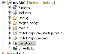

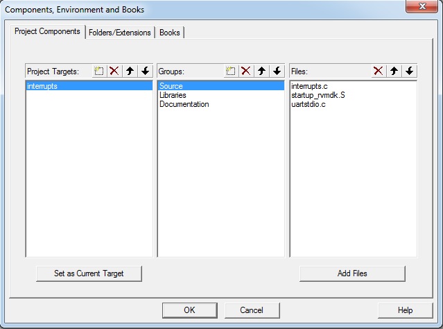

For a program employing UART if you are getting errors like
- Description Resource Path Location Type unresolved symbol UARTprintf, first referenced in ./main.obj
unresolved symbol UARTStdioConfig, first referenced in ./main.obj

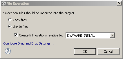

Then you have not copied or linked your uartstdio.c file from utils/uartstdio.c
