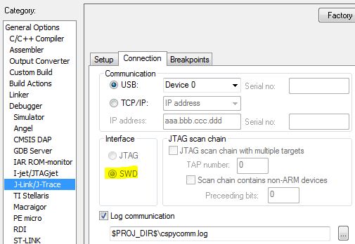

- Tried to change the connection option on IAR's J-Link settings from JTAG to SWD, no results.

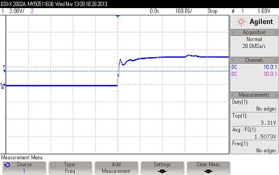

    I also read elsewhere that the power up can be particularly critical, this is a scope view of the power up voltage.
    I must be forgetting some really stupid detail, I can't assume that three uC's were shipped faulty, from three different shipments...

    Was going to quickly suggest your switch-over to SWD - but note that you tried that.  (SWD nicely escapes any TDO issues.)  Your schematic is very similar to ours (for LX4F device) - but for the 1K series R imposed upon the VDDA pin.  (we filter our VDDA via 3V3 fed thru a 06-03 ferrite bead & 0.01uF C to gnd. - both placed adjacent to VDDA.  (may be worthwhile to shunt out that 1K for quick test)

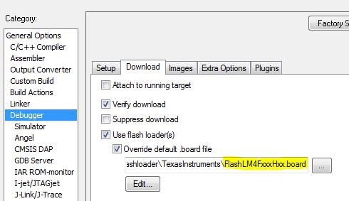

    Here are screen caps from our IAR set-up - always works... (maybe something here aids...) Note: 1st 2 caps show "override default" - I've ticked these "only" so you may note the file "in play" - our Ap. (normally unticked)
    Admittedly this is simple-minded - but meets, "any port in a storm" qualification.  Of course - you must "mate" your chosen MCU under, "General Options" list...
    Should this not prove your issue - you may have to use LM Flash Programmer & attempt "Unlock" procedure.  We have never found this to be a requirement for virgin device - however...
