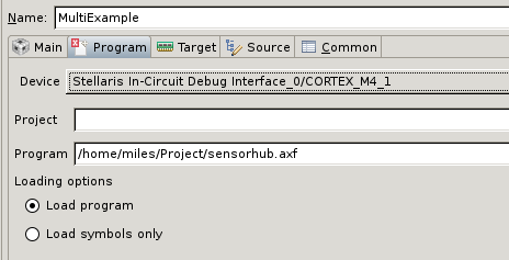

    I'm pretty happy with this setup, but I was wondering if it was possible to load different code into each processor. I'm not really sure how you would go about this. Is it possible to do it using source files within CCS? I'm not really sure how this would work, but maybe building two binaries and passing each to the debugger separately?

    Then, in your debug configuration:
    Make a new debug configuration selecting the target configuration you just made.  You should see an entry for each core in your scan chain.
    Under the "Program" tab:
    The device drop-down now has multiple "dimensions" to the text fields.  ie.  You can enter a different program, one for each device.
