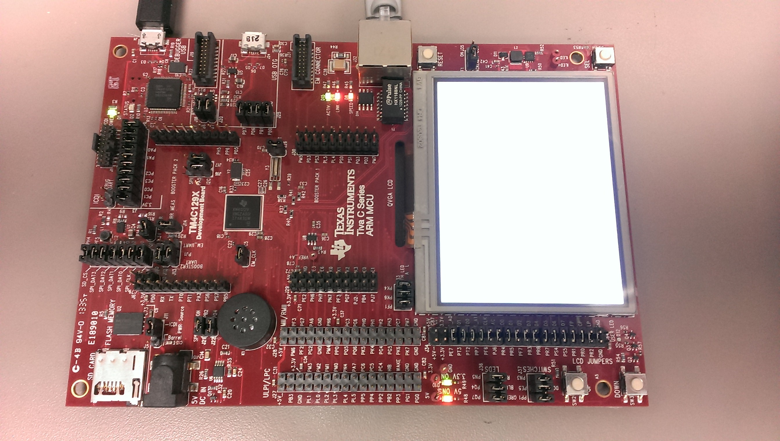

    Mike,
    Can you confirm for me the exact version of TI-RTOS you are using, and post a photo of your development board and a detailed photo of your Tiva chip (so that I can read the revision info).  Also, please confirm that you are using the TI Compiler version and not the GNU version.
    At the moment, it seams something must be different between our two setups because I just downloaded and debugged my target 10 times with 10 successful assignments of a dynamic IP address.
    On the DHCP client side, without adding in the DHCP client in the TI-RTOS config, I cannot get my board to be assigned an IP address.  So as far as I can tell, it does matter to have this included.  Again, something seams different about our setups.
    I've included a photo of my board and Tiva chip.
    Stuart
  • Stuart,
    My compiler version is "TI v5.1.3" and TI-RTOS version is "1.21.0.09". I've attached photos of my board. The chip looks to be the same however there are noticeable differences in the hardware around the Ethernet jack.
  • My board looks like Mike's (re: the parts around the ethernet jack).  Installing the tcpEcho demo and running it *with* the debugger it works "most of the time", but not 100%.  Problem usually occurs on a cold-boot/fresh start -- once the board debugs once it continues to work.
    That said, it rarely works without the debugger running it.  Using a power supply, disconnecting the USB debug port, and hitting the reset button *a lot* of times, it will occasionally come up.  Once it comes up, it will work for a couple resets, but then back to hitting the reset button a lot of times.
    This is using code composer 5.5.0.00077, TI-RTOS 1.21.0.09, and ARM Compiler Tools 5.1.3
