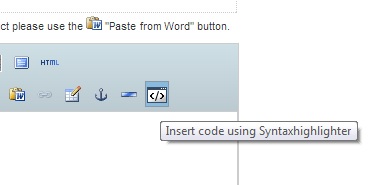

  • Hi Dorene,
         If you want to insert code at your E2E post, there is a "Insert code using Syntaxhighlighter" tool. See, below. You, can also preview your reply by going to the "Preview tab". This way you know everything is what you expect it to be.
    -kel
