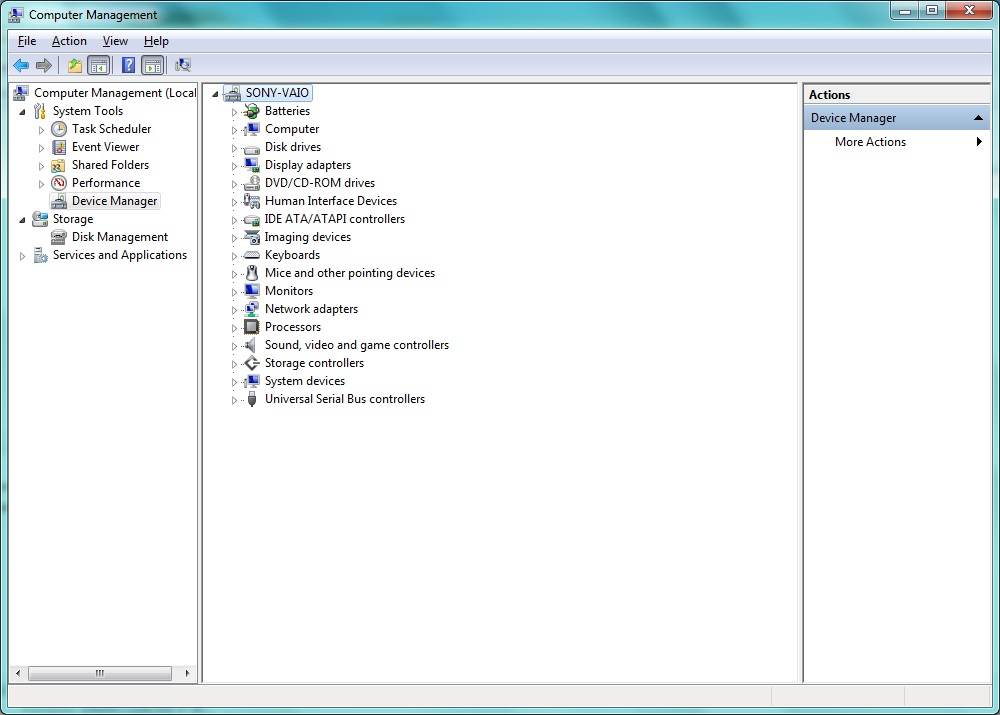

  • Hello Rajat,
    Which LaunchPad are you using? And on connecting the power what does the device manager (snapshot) shows?
    Amit
  • Hello Amit,
    I am using TM4C123GH6PM controller. It does not display anything in device manager about the controller. I tried on different computers and also re-installed code composer. It did not solve my issue.
  • Hello Rajat
    It seems that the ICDI driver has been corrupted. You may have to order a new LaunchPad.
    Amit
